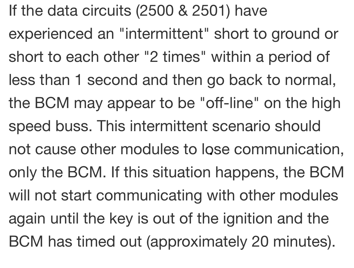

Snapon Scanner.
Good news boys!
My pal at the Stealership gave me a TSB that summed up what I just went through. Tahoe runs good again.

Do you think that it caused the BCM to go haywire?
Totally, it was my fault. The Scanner has mutiable keys that do different things. I created the scenario what that TSB clip states. Sent the BCM into a offline state buy shorting it out over the Data Stream.
