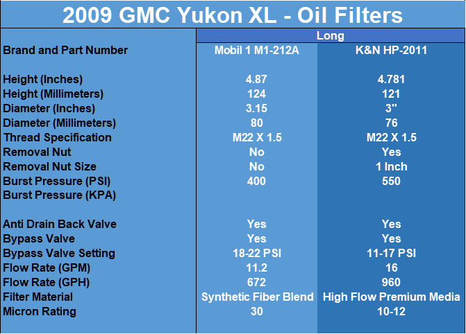

If this were my engine, I would switch to an oil with higher viscosity numbers like Shell's Rotella Gas Truck and change the oil on the DIC when the OLM is about 33%.
M1 EP filter lowers my oil pressure and flows 50% less than what I switched to:
Get a mechanic's stethoscope and have a listen around the engine during a cold start. My motor was a little loud on start up with M1, it's quiet as a mouse now.

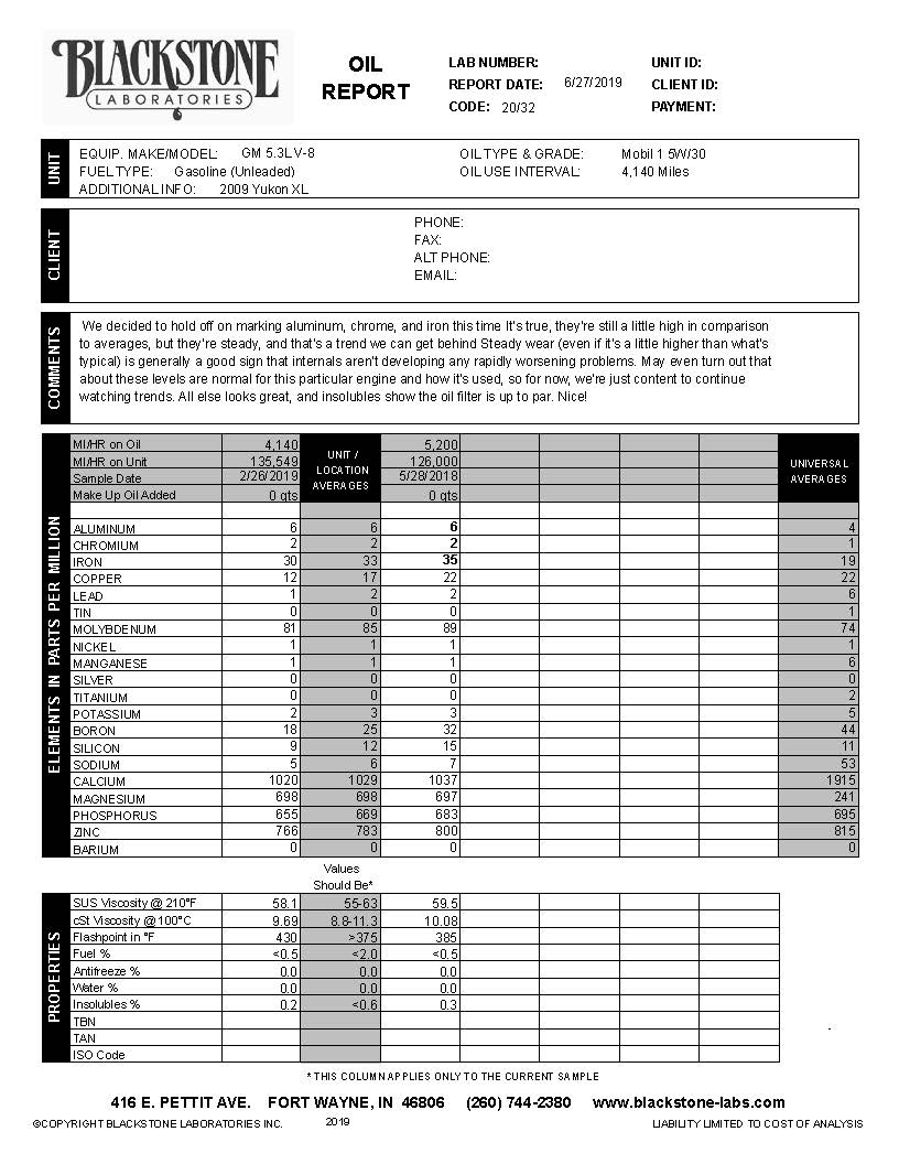

Here is my Blackstone Labs reports for M1 oil. I'll send off a sample of my second fill of ACD in a month or so:
Hope this helps and no drag racing until further notice!
