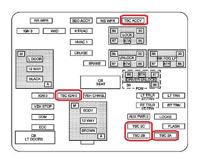

Have you checked the voltages in and out all of the TBC fuses in the Instrument Panel Fuse Block?

No luck at the salvage yard. I'll check those fuses you mentioned @Fless .
