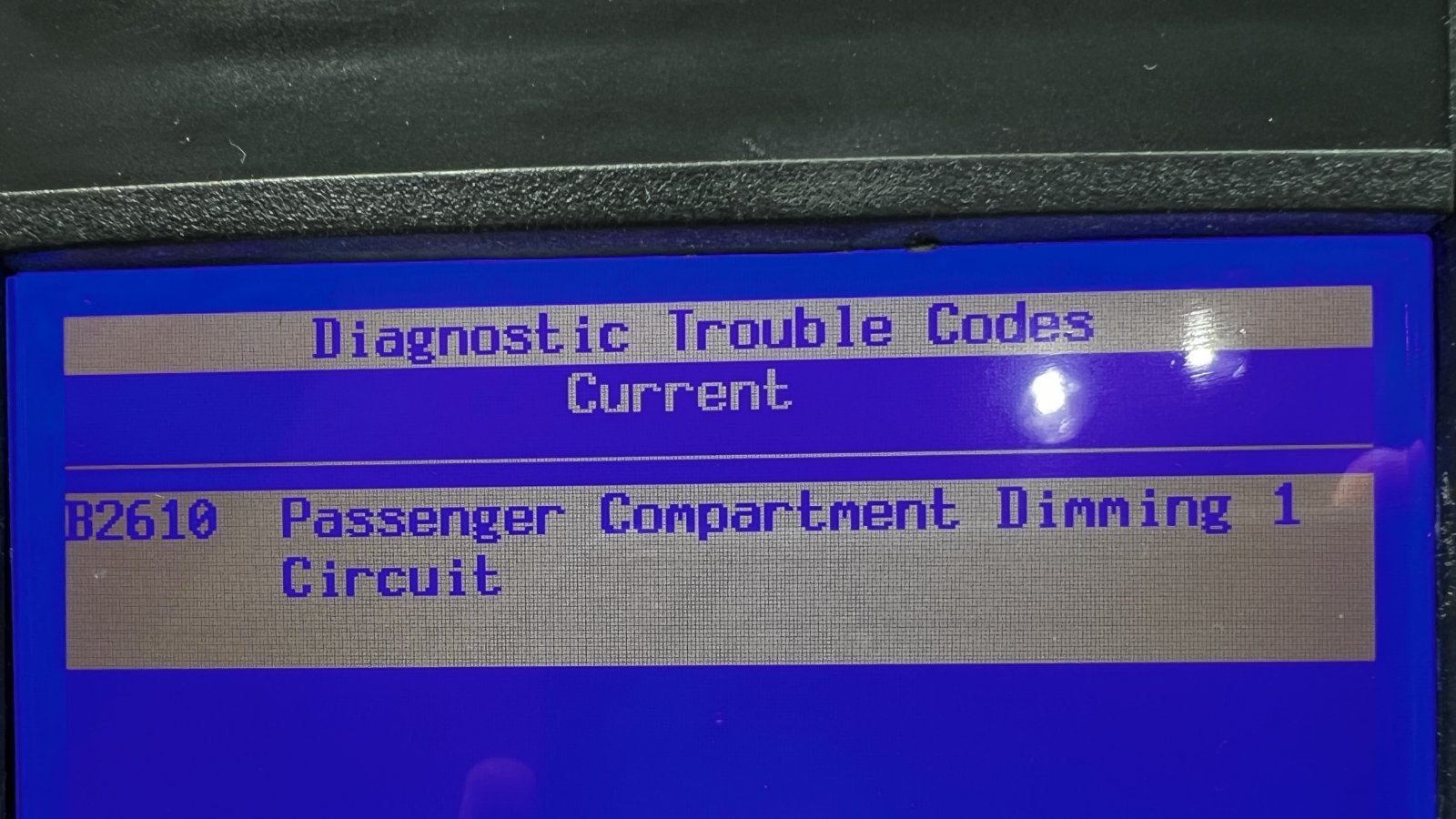

Just learning my way around a Tech2 clone that I finally ordered to assist with electrical gremlins on heated seat (still a work in progress).
While working my way thru the menus etc. I came across a Current DTC of B2610; Passenger Compartment Dimming 1 Circuit.
No indication of a problem on the instrument cluster or in operation of lighting except as indicated below..
Couple of questions:
1. On the Tech2 is there a way to determine when the code was set?
2. Can this be due to LED interior lighting upgrade? Trying to avoid re-lamping with incandescent to find out… but will if needed.

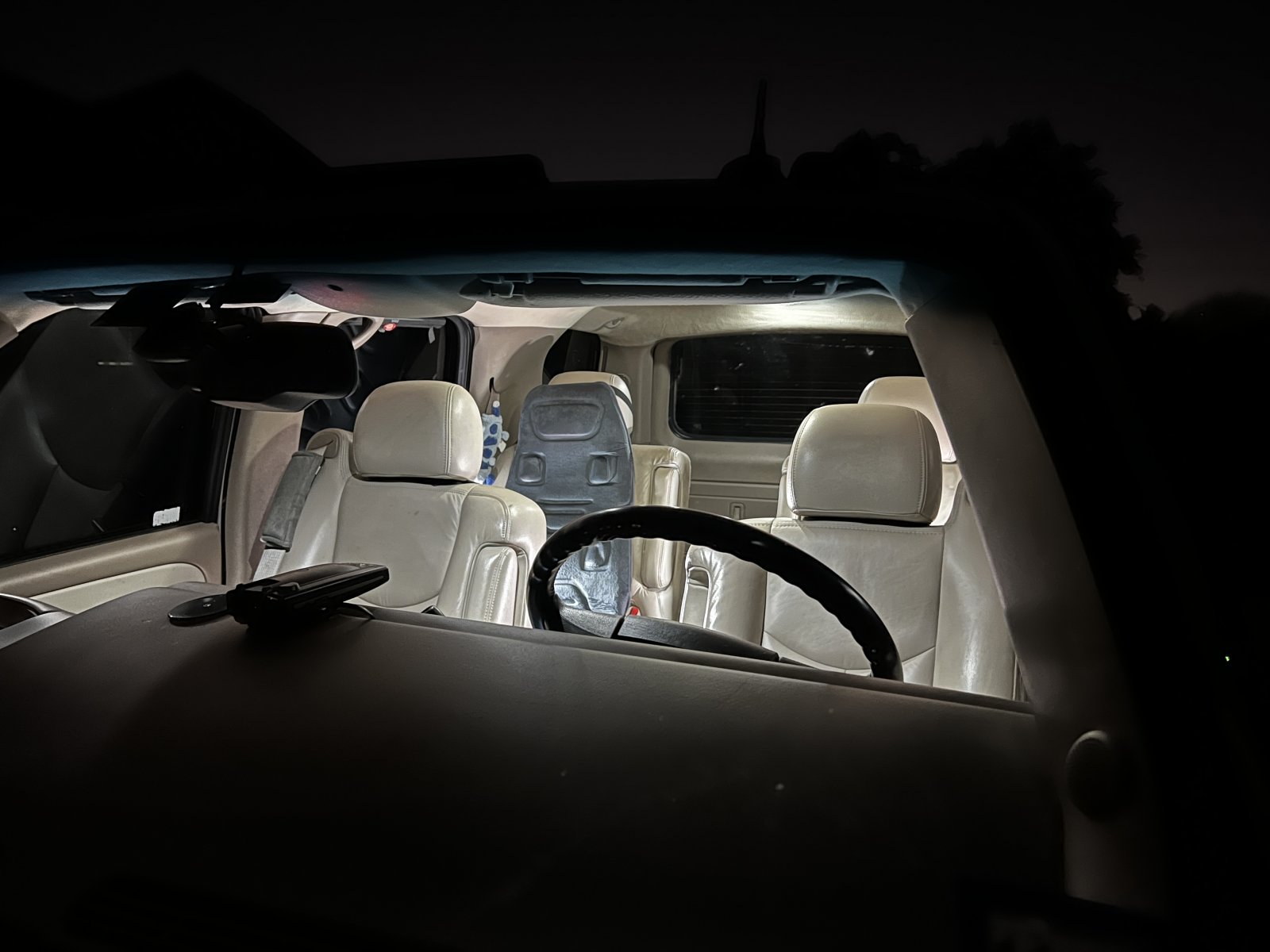

Recently installed LED interior lighting. The lights operate correctly when opening doors etc., but after operation of the vehicle for a while, the reading lamps will not come on unless you first use the lighted vanity mirror which still has incandescent bulbs. I assume that has something to do with the retained accessory power circuit? Or something else to do with the low resistance of the LED.

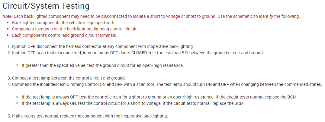

thanks. appreciate this.
the attachment gives me something to go on.
