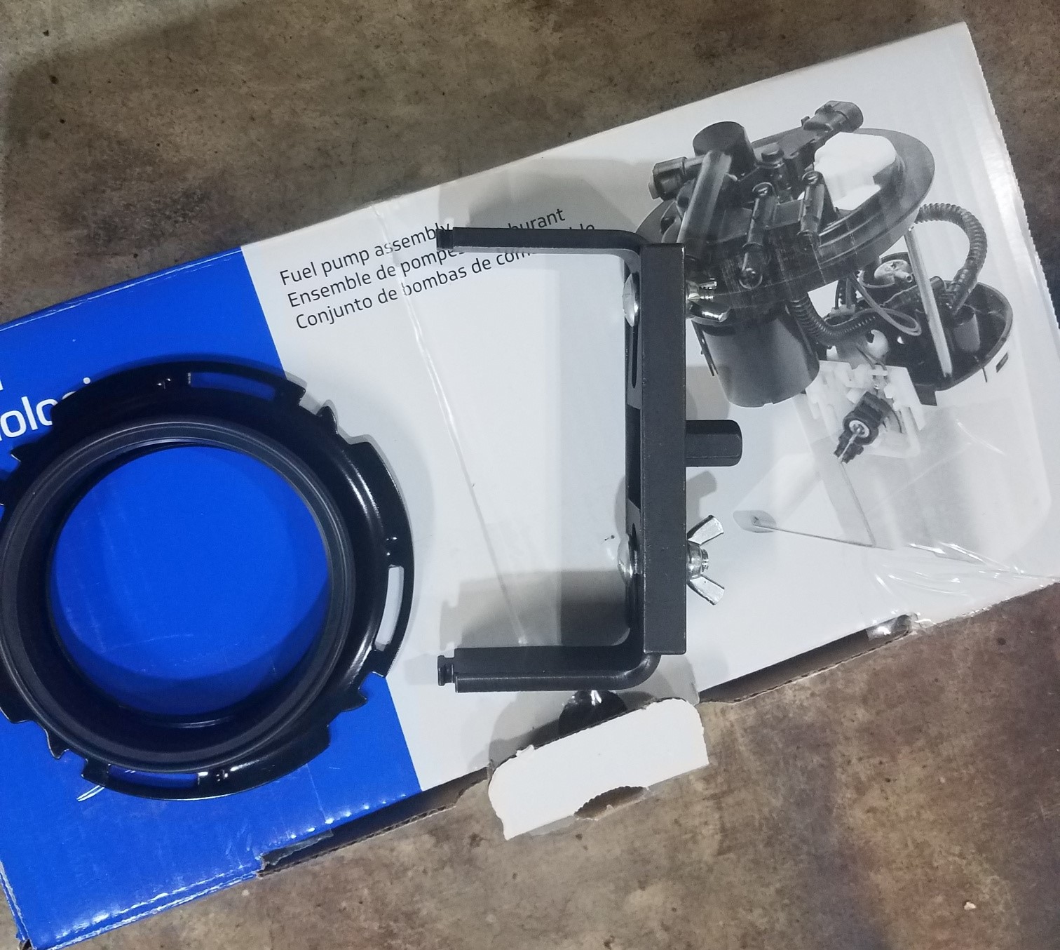

SOLVED. Pump installed and tank back up in place. Wow, much easier dropping the damn thing. Fuel gauge/quantity working perfectly. Filled up. Correct "full" reading then drove for about 50 miles. No issues what so ever. Remained steady with no fluctuations. Didn't mention this in my comments when I replaced the fuel pump almost 2 years ago - but I was having no luck with getting the lock ring off with a screwdriver/punch and hammer - so I purchased a tool. Made removal and install pretty easy.

I didn't need a tool for mine, either time -- we used two channel lock pliers on opposing sides to move the ring. It obviously helps to have two people when doing it.
Mine was a bastard.

Love living in a low rust area. Here's what my new ring looked like after two years. It was new with the pump.

How much was that tool and where did you get it?
Bought it off amazon about two years ago. When I get a chance, I'll look it up. But I believe around $30 or so. My dad always said or words to the affect - A job is only as easy as the tool you have to complete the job. Something like that....
