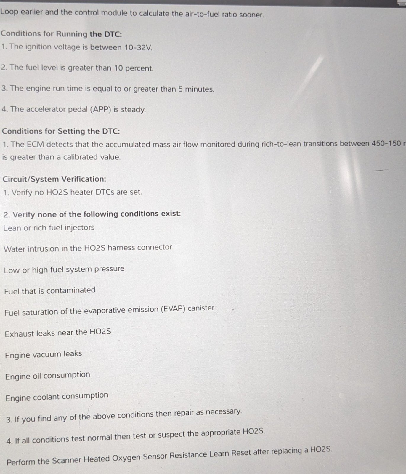

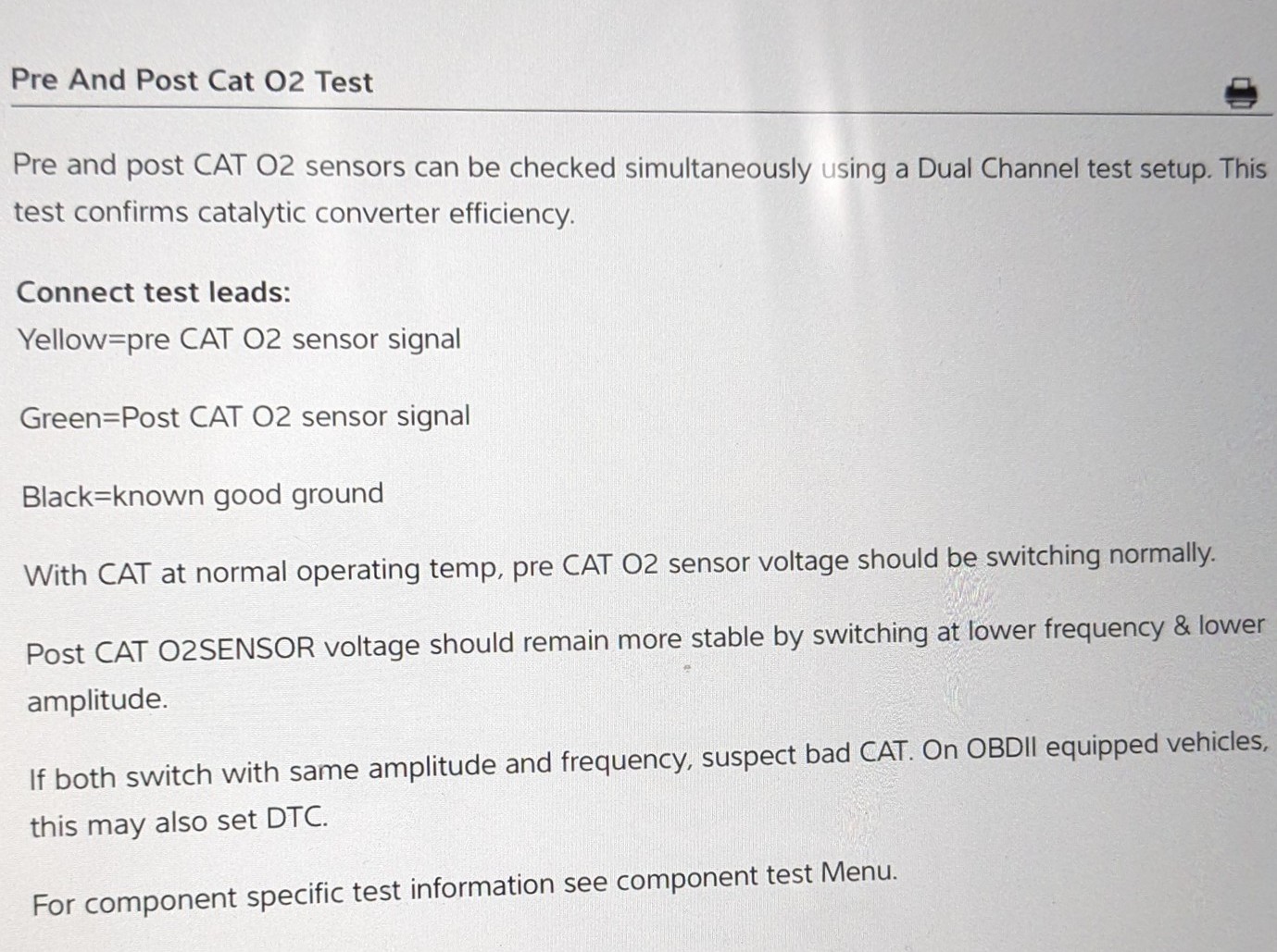

so took a peek and I don't see much in the trouble shooting. looks like it mainly looks for the response time when you lift off the throttle and go into DE mode that shuts off the injectors, if it doesn't show lean within a certain amount of time compared to the front sensor it sets the slow code.
here's about all that looked related.
you can watch both sensor voltages in the scanner, don't need to manually hook a volt meter up. graphed would be best if it will do it. up to temp and in closed loop when the front sensor is switching pretty quickly, see how the rear compares to the front. of they both peak and valley the same voltage, it right be the sign of a cat degrading. compare to the other side that's not setting a code too.
there's talk of a sensor heater reset. I've never seen this in a scanner before, so it may not apply but I've also never looked for it.
see how the new sensor reads.

Thank you very much for this, I hooked up the scan tool today to check things out and the permanent code for it is gone now and the monitor for it says ready.
I plan on throwing the new one in just to be sure, and maybe taking the Bosch one and putting it on bank 2 just for fun and playing around with it. If the code for bank 1 appears again I’ll go through the troubleshooting process for it. I really appreciate your help. With it happening months in between I wouldn’t doubt it’s the sensors at all
