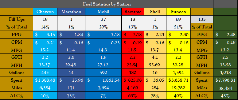

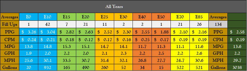

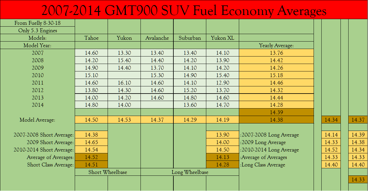

When I was driving my XL with all-terrain tires for Uber, it would average 15 to 16 mpg. About 2 years ago I took the average of all the GMT900 wagons with the 5.3 on Fuelly and learned that they ALL average 14.3 MPG.
Here's my truck's chart over the last three years on all types and brands of fuel:
If you burning 87, you're going to get crummy gas mileage.
