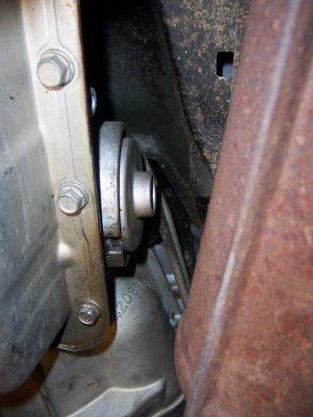

This is the 2-4 servo cover. See if you can push it in and measure or just try judge how far it moves. If it moves more than an 1/8 of an inch, the band is worn or pin is too short. Need a longer pin or new band which a band is rebuild territory
I was finally able to get under there and feel for it. I wasn't able to push it in at all. It just wouldn't budge by hand. Perhaps I could have use some leverage, but I am assuming just trying to move it by hand was the appropriate test. What does that tell us?
Sorry should have been more specific. You will need something to pry against it with. Let me see if i can come up with a video for you.

Well i was unable to find a video. But you need to use a pry bar on it. Use either the torsion bar or frame as your pivot point.
Thanks, Mudsport96. Sorry for the slow response, I assumed I would get an email notification, once someone replied. I'll try and get back under there in the next few weeks. Thanks again!
