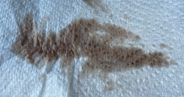

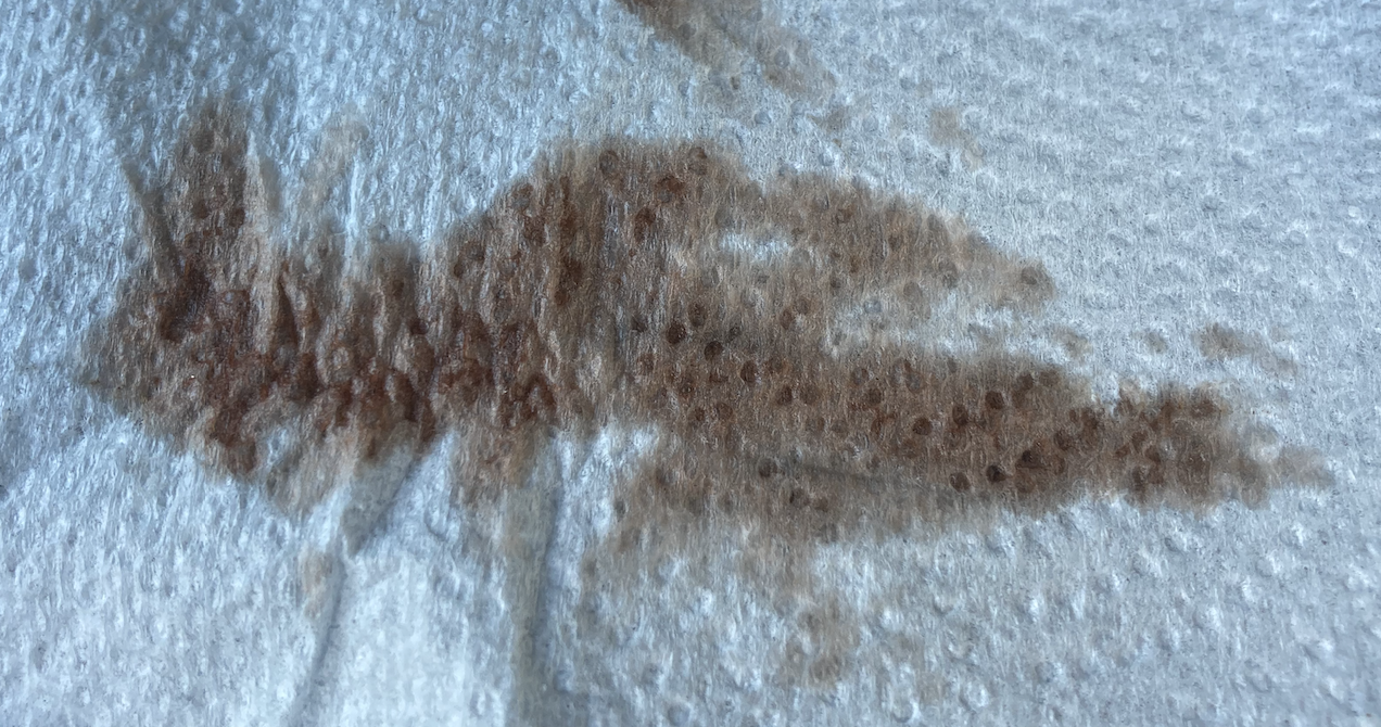

Id be interested in the state of the fluid. Is it burnt smelling? Bright pink or more brown to orangish in color?
It's a bit hard to tell from this attached pic. (The blacker areas are from the black fan shroud behind it - the fluid makes the thin paper towel kind of transparent. So, it looks better in "real life".)
I'd say it's reddish with a hint of brown in real life. It looked darker before I added the 2 bottles of Lucas (about a year ago?). A year ago I would have said it was pinkish red, with a brown halo around it.
No burnt smell. It smells kind of like oil.

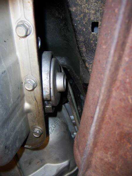

Give me a bit as im at work, and i will see if i can find a video of something i want you to check.
Mudsport96
Jun 6, 2020
1,421
2,331
40.923,-89.488. Illinois
This is the 2-4 servo cover. See if you can push it in and measure or just try judge how far it moves. If it moves more than an 1/8 of an inch, the band is worn or pin is too short. Need a longer pin or new band which a band is rebuild territory
