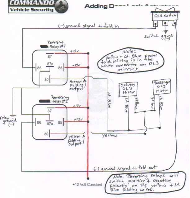

I did find this which shows how to wire them if you don't have power fold from the factory.
Seems like a DEI 611T in place of that rocker switch would probably do it.

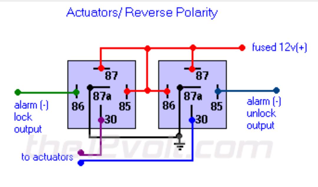

Or perhaps..
Now substitute a DEI 528t combined relay/timer for the above relays to give you a timed pulse (about 3 seconds each way).
