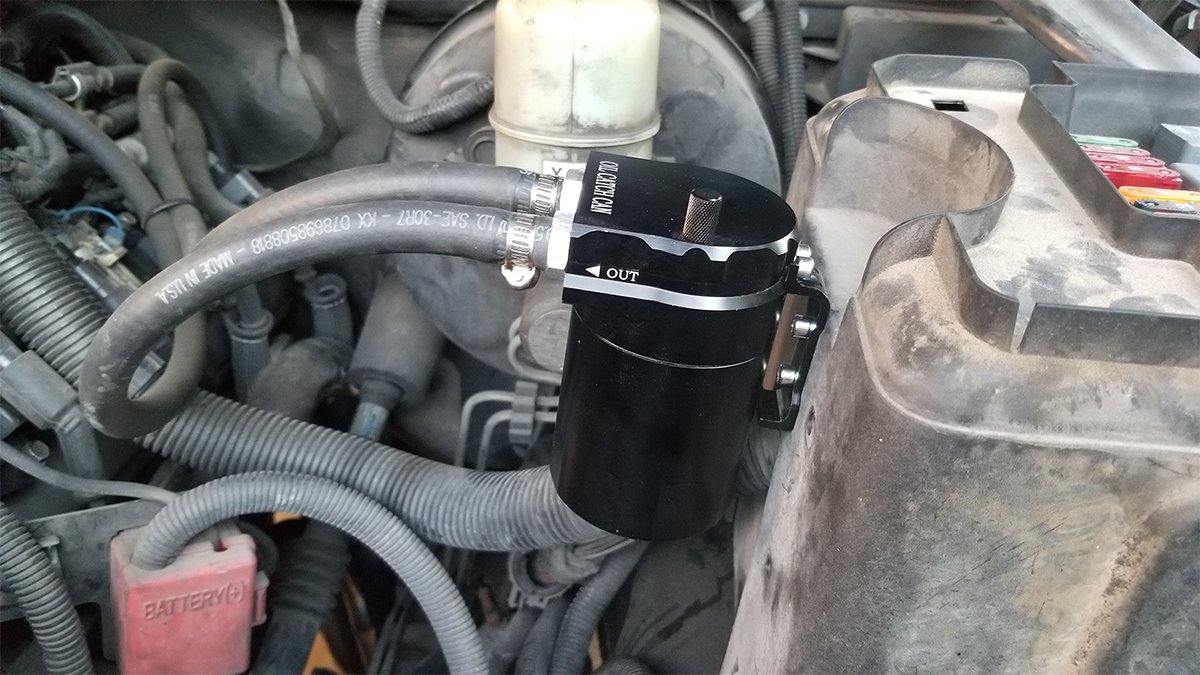

Finally got around to installing a catch can since everyone and their mom is doing it. I went with a cheap one from Amazon if you can believe that. http://a.co/d/15Moslg Mounted it to the fuse box since it seemed the easiest place to access it when it comes time to empty it. I wish it didn't have that stupid engraved crap on the top, but oh well. Guess I need to clean up the engine bay a little too, but a dirty, working engine always makes me happier than a clean, non-working one...

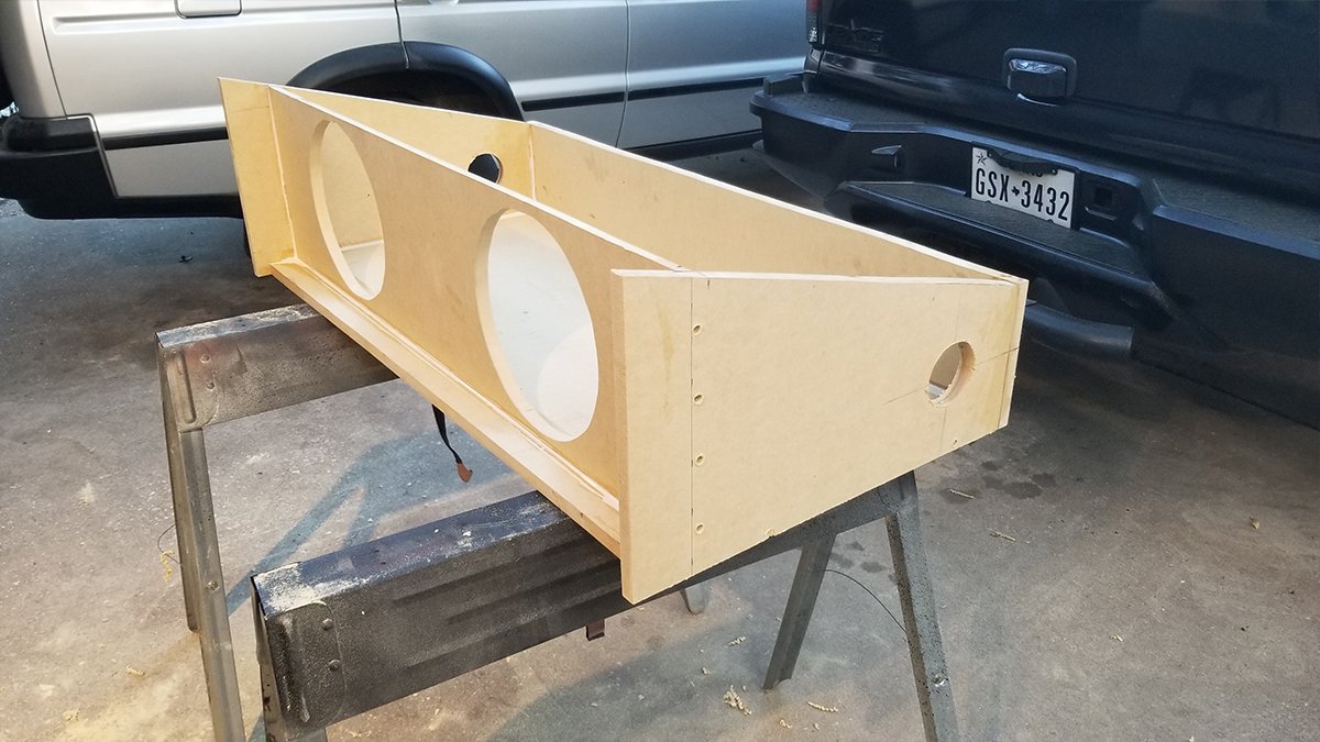

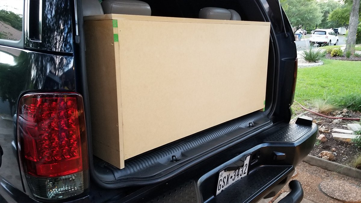

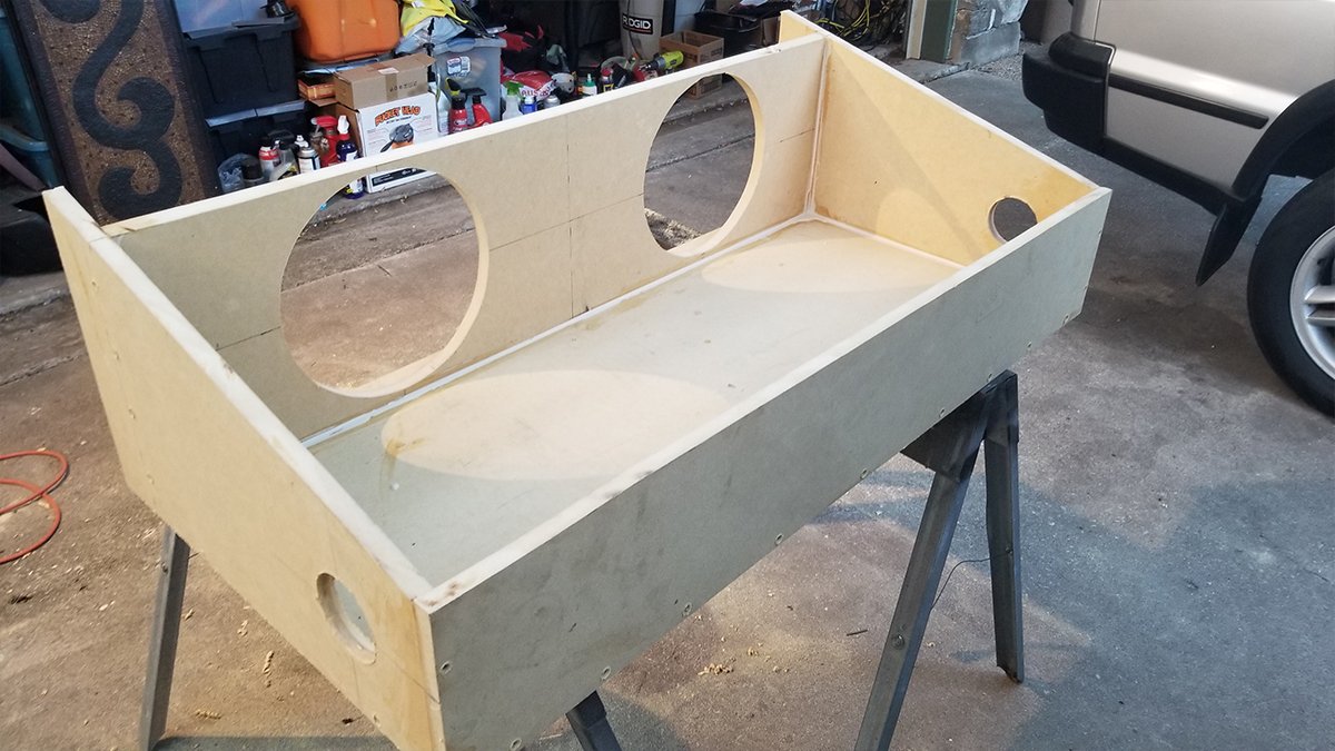

Started building my new 12" ported down-firing Subwoofer box/enclosure for behind the 3rd row too. I have a cheap pre-fabbed box that has done me well for a few years now, but I've been wanting to build my own forever. Just used 3/4 MDF, wood screws, and Titebond 3 wood glue. Should be tuned right at about 36Hz and the airspace is about 4 cu ft total. I'm getting black carpet to cover it today to match the black carpet that I'm installing in the Tahoe in a few months. I haven't installed the bracing, sanded it down, installed the banana jack binding posts (for sub wiring), or the port tubes yet, so she's still a work in progress. Should have it all wrapped up this weekend. Fits like a glove back there.

That’s going to be a nice clean setup, and should be really musical as well tuned at 36hz.
Yeah I hope so, I have these Pioneer TS-W3003D4 12" subs going in there that have really been awesome speakers, especially for the price.
