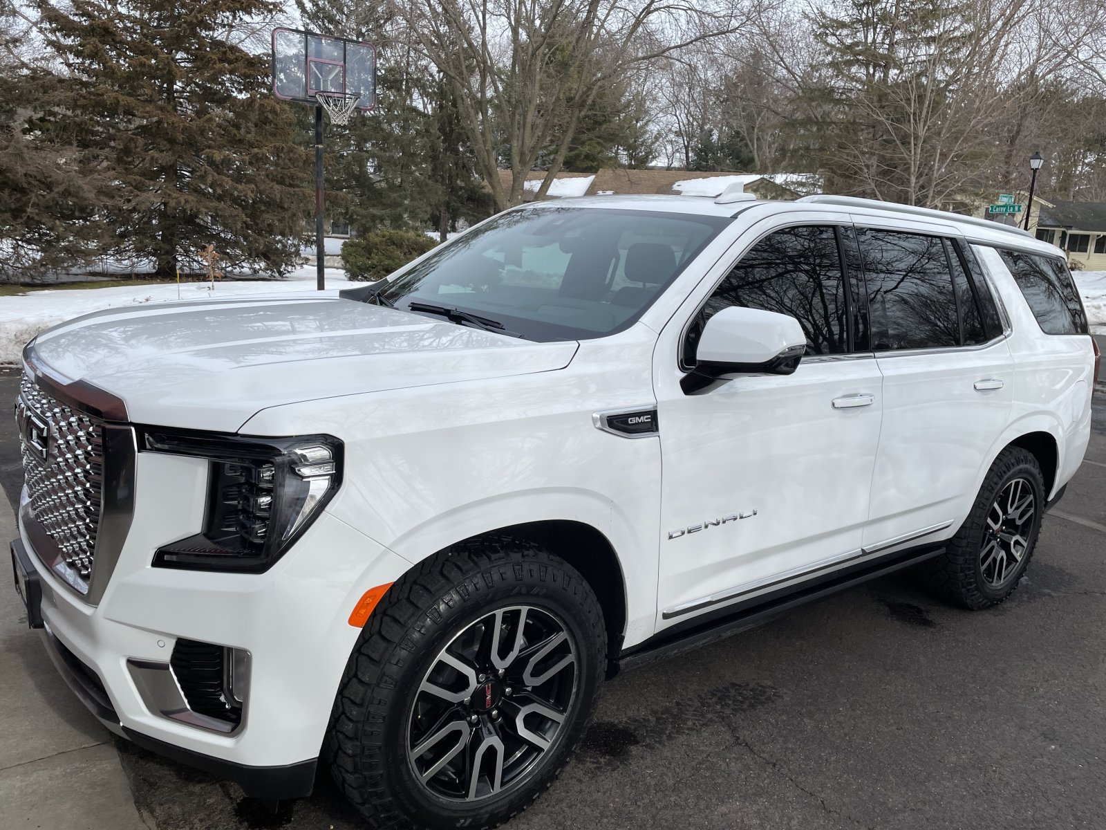

From my understanding aside from the engine difference between the two and the greater approach angle of the AT4, they are mechanically-identical in t-case, four wheel drive systems and off-road settings. My Denali has adjustable ride height and drive modes identical to the AT4. Hell, mine even came with AT4 rims! ;)

Really, those tires/wheels?! That is an option?!
