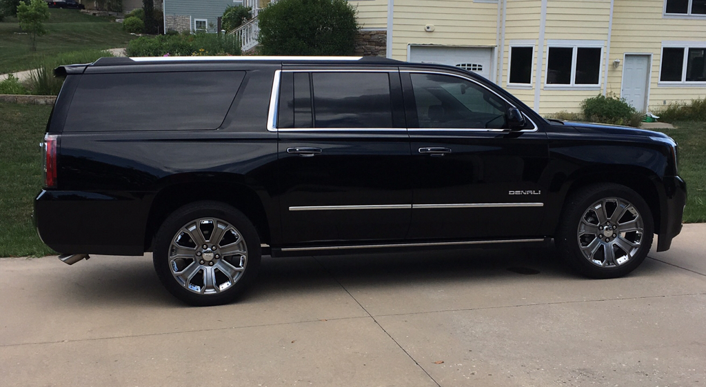

At the point of getting rid of our 2016 Denali
fordfest
Dec 30, 2017
48
31
I shared this in the suspension section and realized it is best suited here. Just because my forum name uses Ford, we have been diehard Denali owners for 15 years.
It is insane that we have to consider swapping out numerous suspension components on a SUV with a msrp of $80k+! We have owned 3 Yukon XL Denali over the past 15 years. While the styling and looks are great, the ride simply sucks. Due to the ride, we have countless rattles that can't seem to be corrected and the rear glass/spoiler keep coming loose, also due to the rough ride.
I'm actually giving it a full detail today to put it up for sale or trade it in. We have hit our max with this car. It is a shame that GM hasn't addressed the ride issue. I don't get it, just reprogram the computer or turn it off. There is no way this wasn't seen during development. Every visit to the dealer I mention how it has a horrible ride and ask if there is a TSB. All I get back is the deer in the headlights look. To my knowledge, our dealer has not made one phone call to GM about the issue.
We are still young enough we would have several more of Denali in our future if it is what we have come to expect from the 2007-14 models. That model had a couple of minor interior issues that were addressed with a simple low cost fix.
It makes us completely sick that we are at the point of getting rid of our Denali. At this point, we have no idea what we are going to replace it with. We have been loyal to GMC because we liked their full size SUV. If I could have back our 2007, we would gladly make the swap.
Sorry, to vent. This is the only place where people actually understand what we are dealing with.
