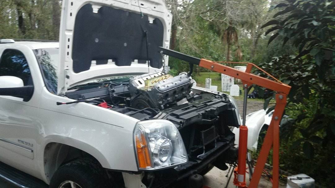

received_10214728834675162-jpeg.185167
45,016
The engine for the back wheels is easier to work on
