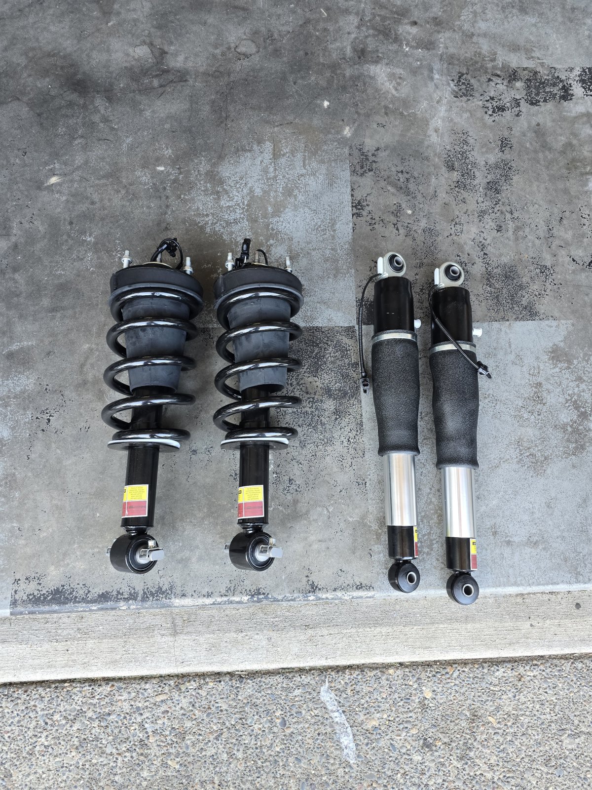

At 125K miles the struts gave up on my 2018 Yukon Denali. Replaced rear shocks as well. Pretty easy to replace all 4. Now it rides so much better. Still rolling on the original brakes with plenty of pad left.
I have 16.25" front rotors with 6 piston Brembos forcthe front & 4 piston Brembos for the rear juat waiting for me to install.
I went with aftermarket mag ride struts that have a lifetime warranty and way cheaper. Time will tell if this was the right choice.

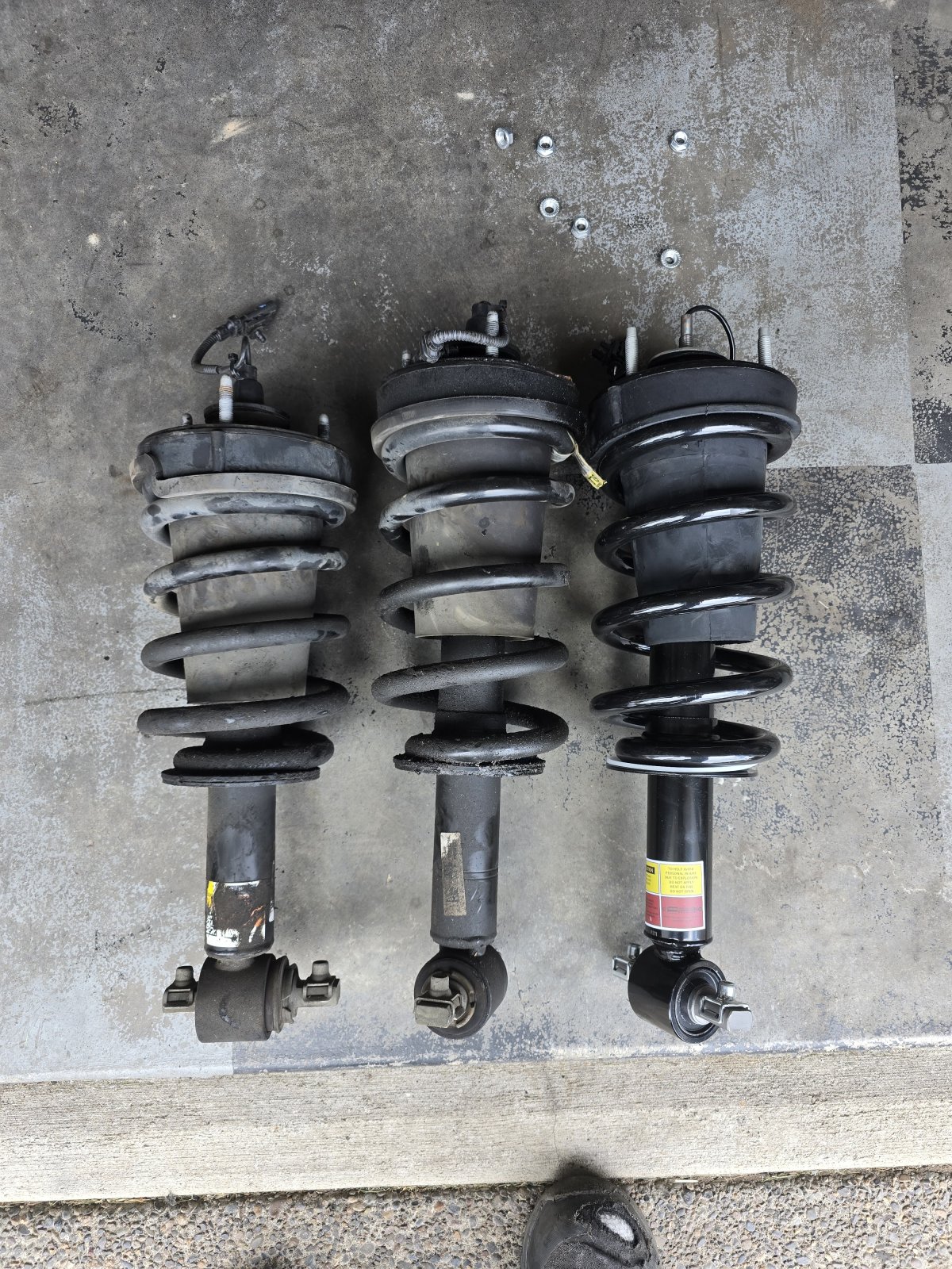

I've had my 2018 for 2 years and recently hit 170k. I did my front struts a week ago and couldn't believe how much better it rides by comparison. Feels like a new truck! Until the alt died a week later and I was reminded that it is not a new truck.
Old vs new
View attachment 461959View attachment 461960
What brand did you go with? I’m due for rears. I did the fronts about 2 years ago. Didn’t notice a difference really.
