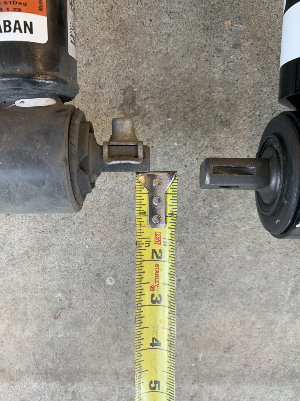

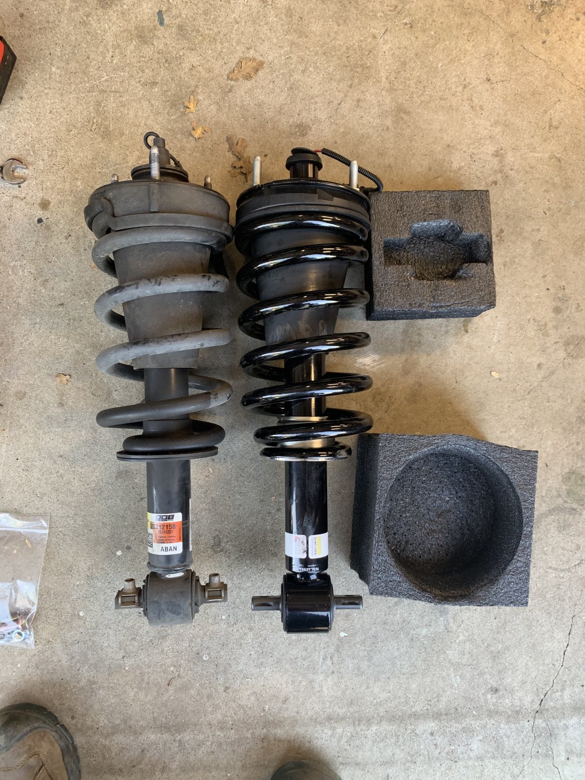

The Arnott fronts are 1/2 inch longer than the oem 2015 Yukon xl Denali.
Don’t know if the spring rates are different. Knowing eibach then yes.
the front is Definitly leveled now.
3 of my shocks had gushed oil but hadn’t locked up... so these obviously ride better.
no idea on a side by side. But I’ll tell you this much.
They won’t chatter in 80° heat like the crappy mrc.
