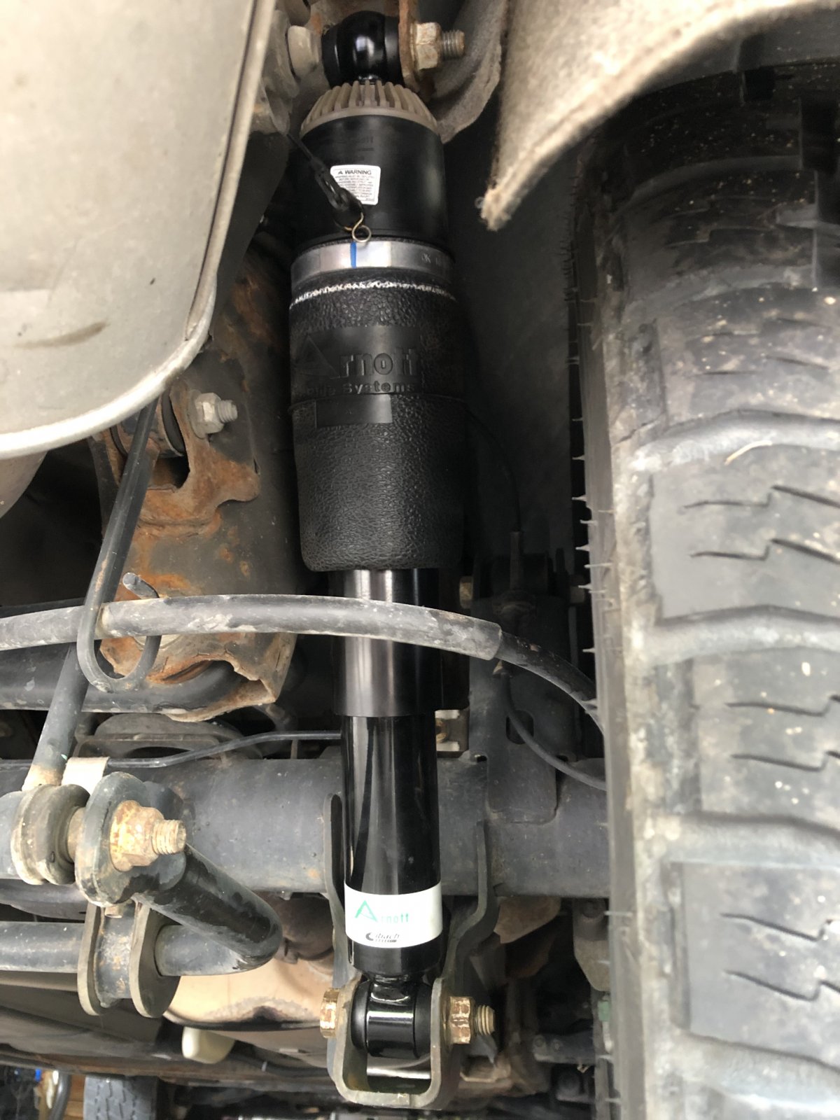

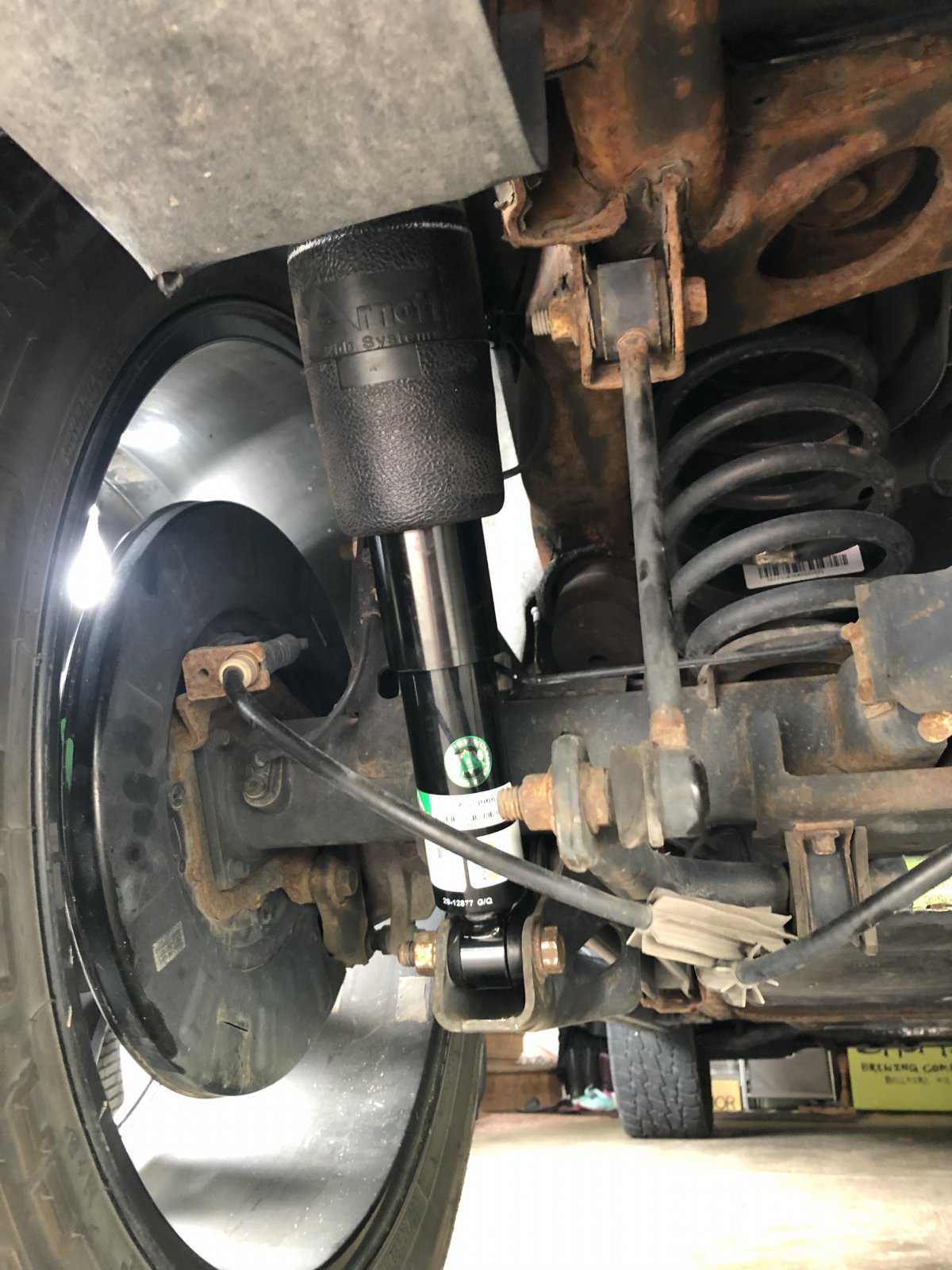

I used the Arnott replacements for my air shocks for my 2007 GMC Yukon Denali XL. In addition to changing the shocks you also change the rear springs to beefier springs. The electronic device keeps the computer from from displaying an error code on the dash. I love the ride and the price is better than replacing the air shocks with new air shocks. The only difficulty I had was doing the spring compression for the front shocks. I had my local shop compress and replace the two front assemblies and then reinstalled them myself.

I just replaced my Magnarides with the Arnott struts and shocks. I wish I knew about them sooner they are so much better than the Magnaride junk. The front struts come with springs with an extra coil and heavier gauge wire than factory. I had a leveling spacer but the front was still a little lower. The new struts even it out real nice. Best part is that with the heavier front springs it does corner better.
