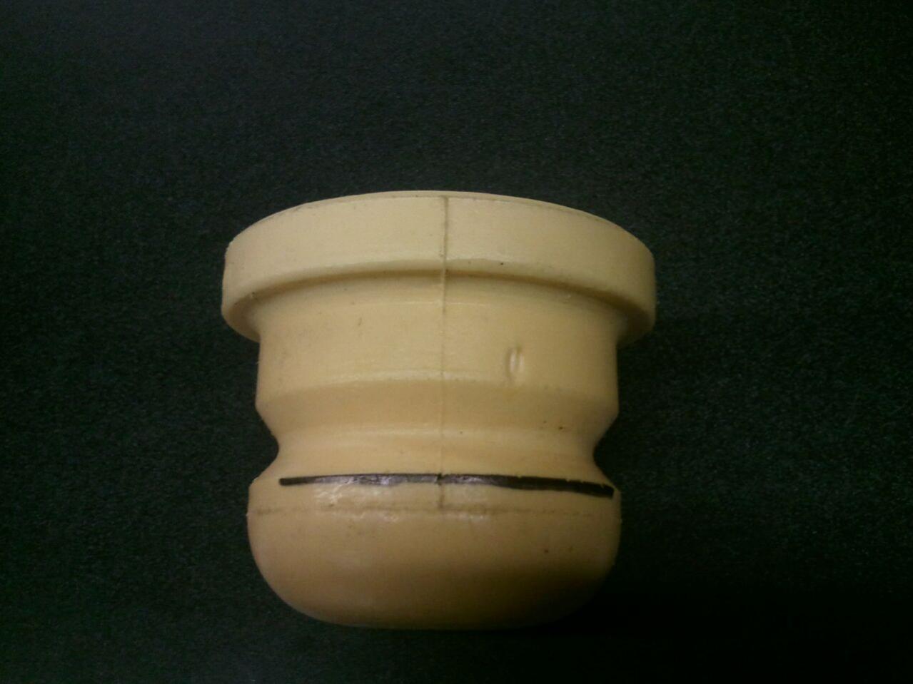

I don't think i've posted this before but you can cut the rear bumpstops to get more travel in the rear. This will get the most travel you can before the truck would slap axle on frame. If its still ride bad after this then its time for the free travel mod
Just cut it along the black line i show here and you will be good. Use top portion not lower cut portion
