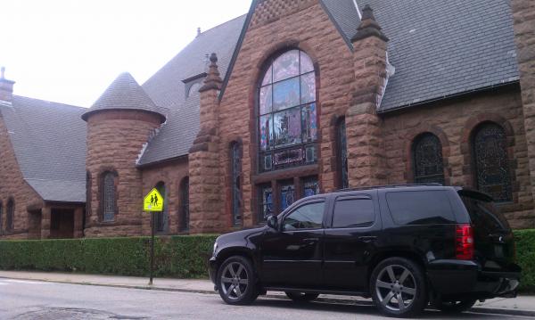

Anyone running these 22’s and lowered on your Tahoe. Pic inside

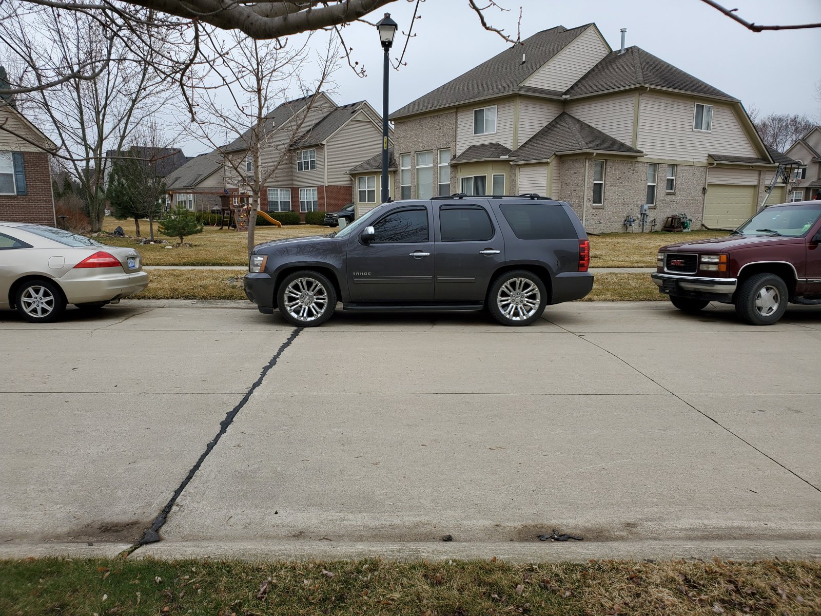

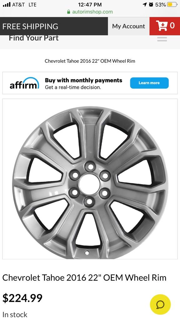

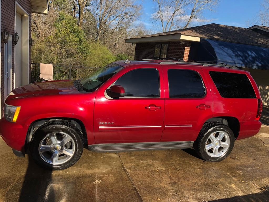

I’m trying to get an idea of what these would look like on my 2010 Tahoe. Trying to find a wheel I like for the color so I can lower it
My Tahoe

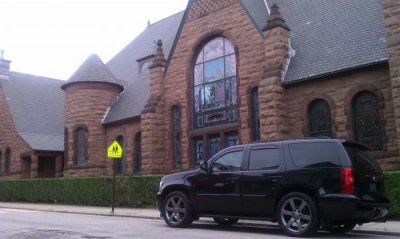

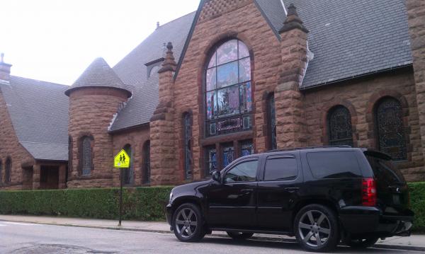

It’s not a super clean image but most of the popular wheel sites let you choose your rig and change out the wheels. Good luck.

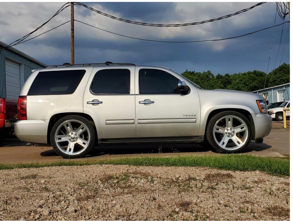

FWIW, I think those would look great on your rig. More pics and details please!

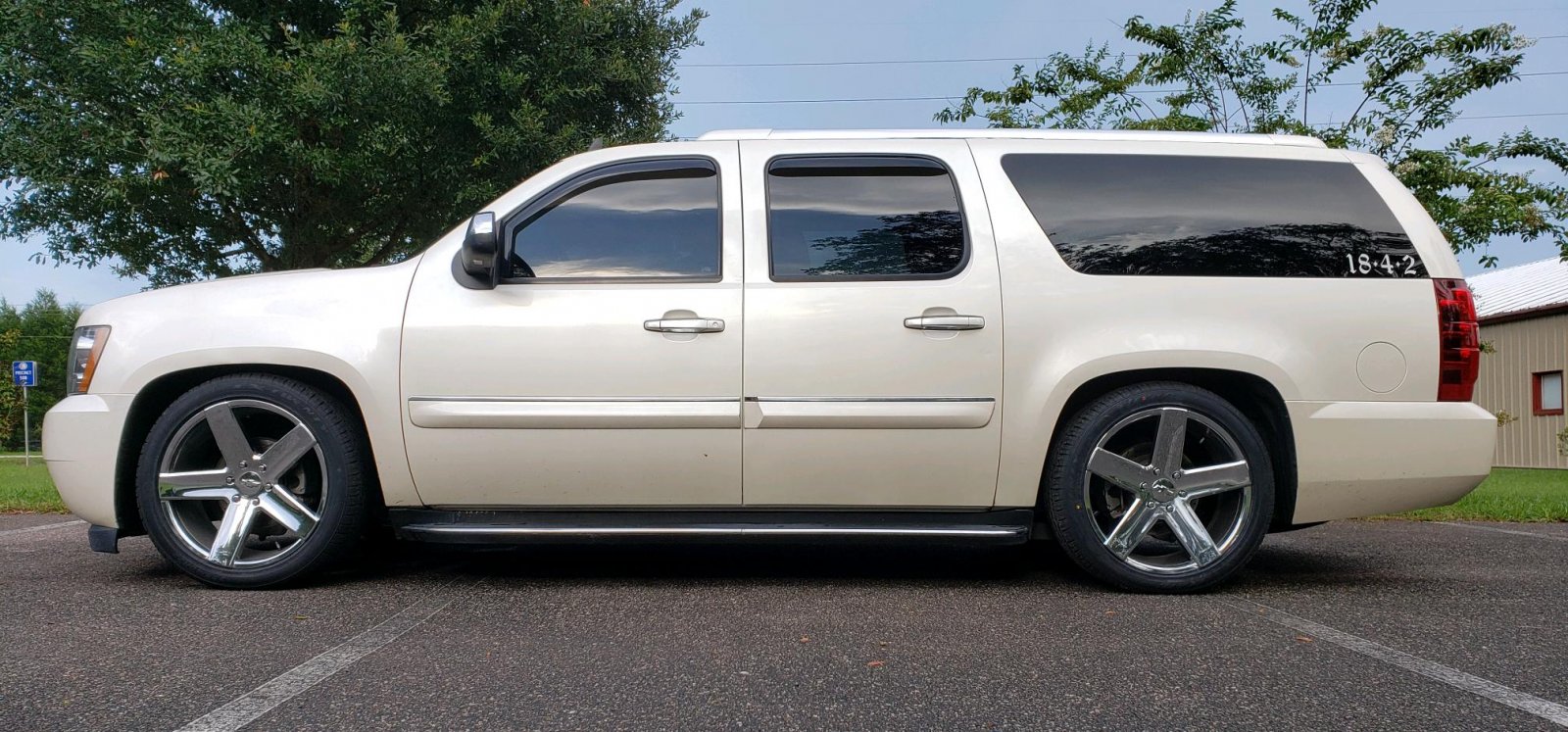

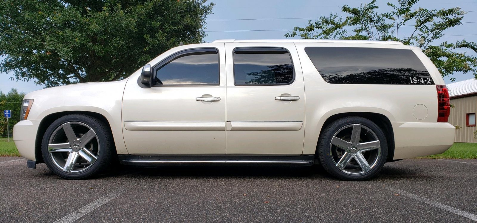

I almost went with these as well, but ended up with Heavy Hitters because I liked the spokes without holes better...
What drop do you have and what kit? I can’t decide if I want to do a mild 2/3 or a 3/5. I want to maintain a slight rake as well. I don’t want to be level because I may tow or take family trips loaded down
kbuskill
Mar 11, 2017
5,822
9,833
NE. FL.
It is Tony's @NORCAL SS 4/6 kit... kinda.
It started off as that anyway.
I didn't like how soft the Belltech drop struts were so I ended up replacing them with Rancho 9 way adjustable struts mounted below the control arms with grade 9 hardware from Rough Country. Still have the 2" drop spindles installed.
In the rear I wanted to maintain the Auto Leveling feature so I found a set of air shocks that had the same compressed/extended length as the Belltech drop shocks and installed those hooked up to the factory air compressor.
It rides softer in the rear than what I like but I plan on correcting that eventually.

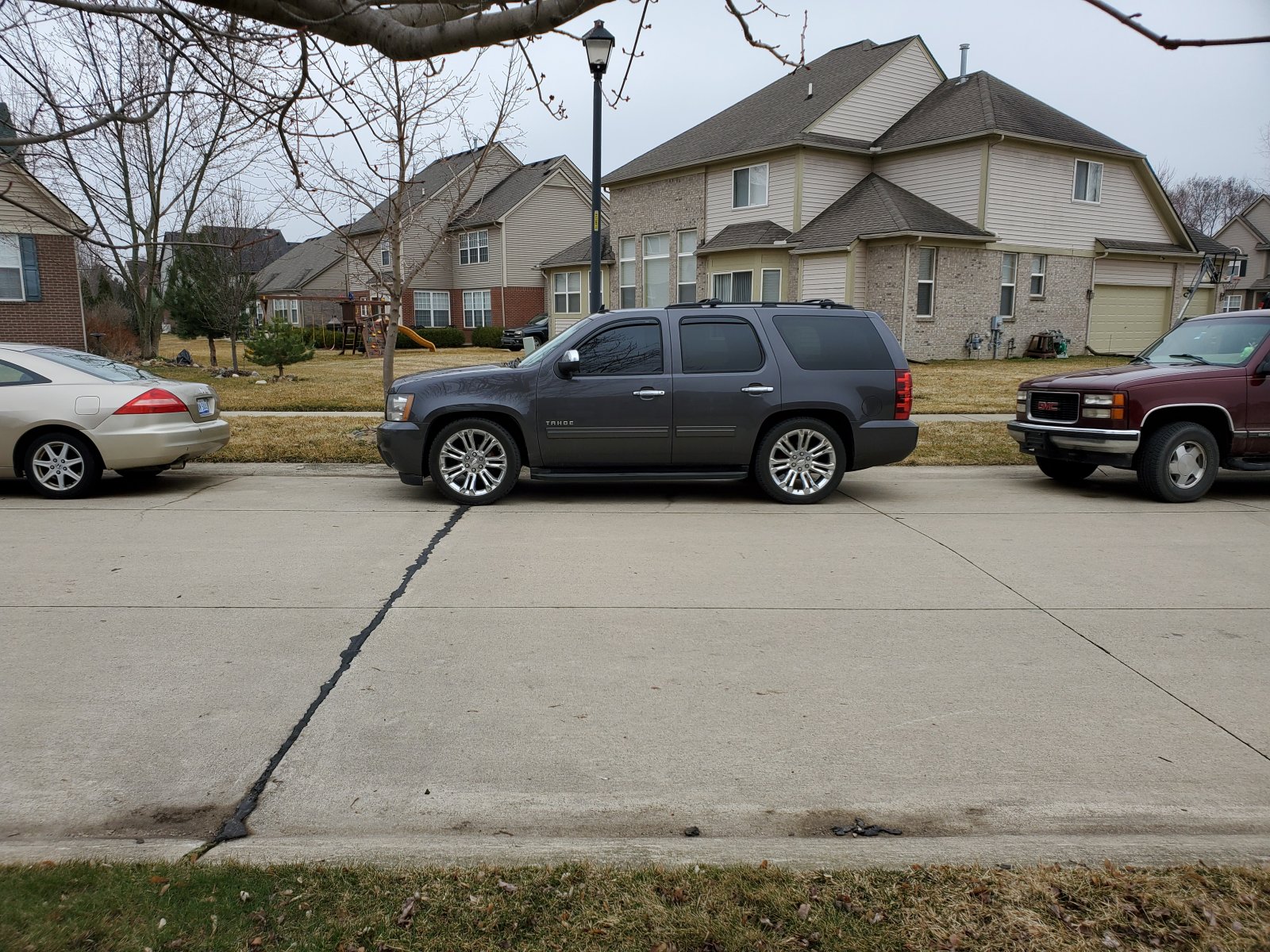

Man that look good. I’m going with the 2.5/4 or something close.
Thank You!! I think that drop you are getting would look Sweet!! Damn roads here in MI is what kills it for me. Get some pics as soon as you get it done!
Yeah those do look sweet!! Always been a fan of those wheels! Truck looks good!!
