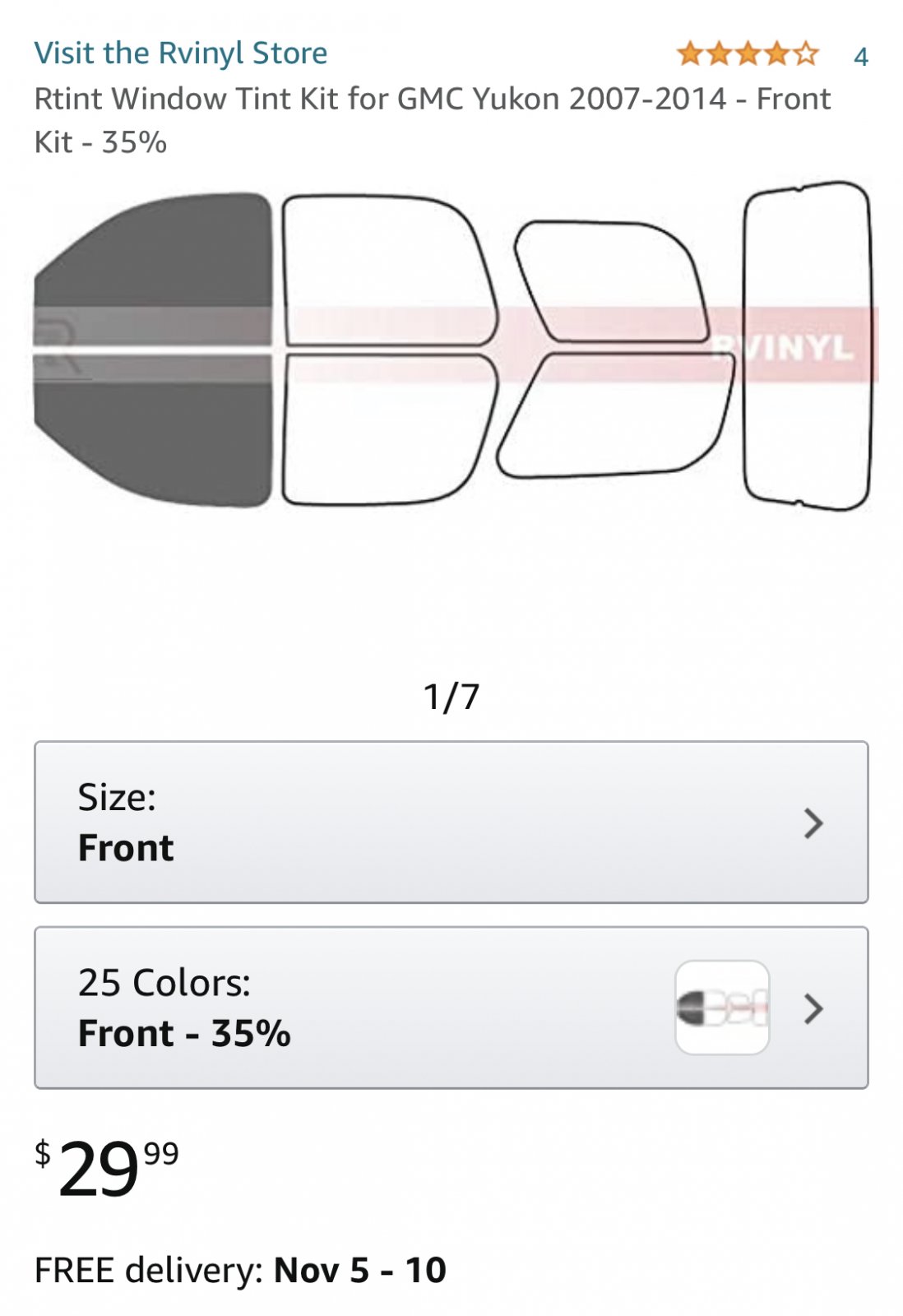

Been looking at tinting my own windows and have watched a few videos on it. Just wondering if anyone has done this themselves? I was looking into pre-cut tint such as this...
Any recommendations are greatly appreciated as I’ve never done this before!

I have done a few of my vehicles when I was younger. The pre cut tint is definitely the easiest route to go if you insist on doing it yourself.

I've used the precut stuff from rtint. I'm not particularly good at it but it came out fine. Would use again.

Window tint is really a you get what you pay for item. You aren't saving enough money to be worth the hassle if you are paying $30 for the materials. Cheap tint places usually charge $70-$100 depending on tint brand for just front door windows.

As others have mentioned, it's not difficult to do, but it is difficult to do perfectly. I've done several of my own and the pre-cut tint does make it easier, but it still doesn't end up perfect. If you are a perfectionist, take it in to a reputable shop.

I put that on my 01 years ago. Stuff was fine, no scratches from inside felts and lasted until I sold it 12 yrs later

I have used the pre-cut tint several times now and it is definitely worth doing it yourself. You will need a spray bottle full of soapy water, a squeegee, and a hair drier or heat gun. Baby shampoo works best for the soapy water. Remove your door panels and the window sweep. Clean both sides of your window glass and put you window down about an inch or two. Spray the hell out of both sides of the glass and both sides of the tint with the soapy water. They begin to peel off the tint from the backing, spraying generously with the soapy water. Place the tint on the inside of the glass and slide it around until you are happy with the placement, you want a small gap all the way around the top edge. One you have the placement you like, start squeegeeing out the water. Use the hair dryer as needed on any areas that need it. Roll up the windows and continue to squeegee out the water down to the bottom of the window. After an hour or two you can put the door panels back on. Wait at least a day or 2 before rolling your windows down. For $13 on eBay and a little work you can't beat it.
