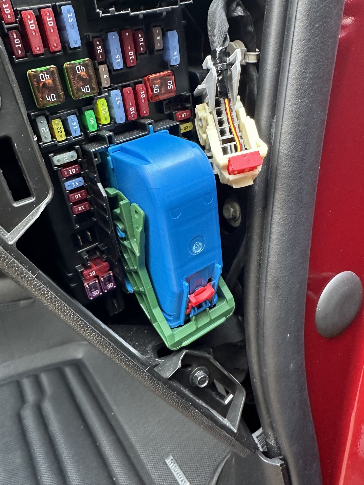

Would you know how to disconnect this blue and green clip? The fuse I need to access is on the back of the fuse box.

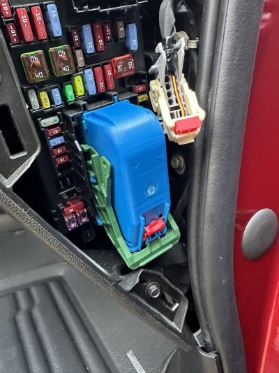

Okay I’m stumped. When I took that fuse out, it acted as if the door was open when I put it in drive. Plugged it back in and that issue went away but original problem is still ongoing. Found the right door panel fuse and it was good but swapped it anyways. No luck.
Everything else looks like it’s seated fine as far as connections. I’m able to roll the window down from the driver side. Just can operate the mirror or use the controls on the door panel. Blindspot is not working as well.

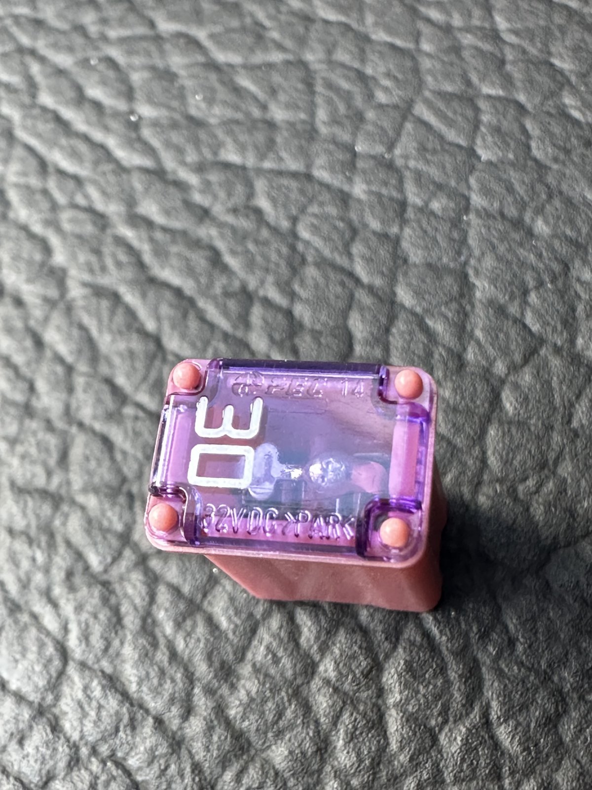

That JCase fuse doesn't look to be blown, at least from my vantage point.
If they pulled the door panel to do the tinting they may not have reconnected the harnesses.

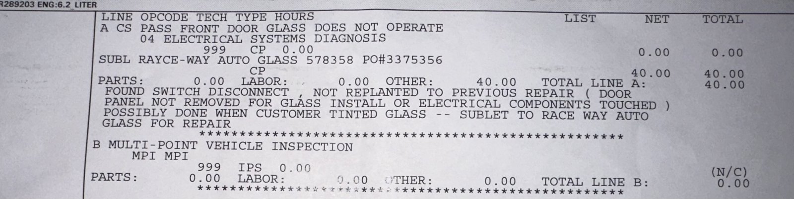

Took it to the dealer and they had to call the 3rd party window installer back out to troubleshoot. Installer says they don’t remove the panel to install the window. Is that even possible?? Installer blames it on the tint place but would fix it for $40 to reconnect a cable. At that price I could care less at this point. It’s working now.
30,763
48,456
View attachment 434257Took it to the dealer and they had to call the 3rd party window installer back out to troubleshoot. Installer says they don’t remove the panel to install the window. Is that even possible?? Installer blames it on the tint place but would fix it for $40 to reconnect a cable. At that price I could care less at this point. It’s working now.
dealer is full of sh*t the glass has clips, tint places do not remove the door panels to do tint, the tint is cut to fit the glass just beyond the rubber seal edge and just presses on.
