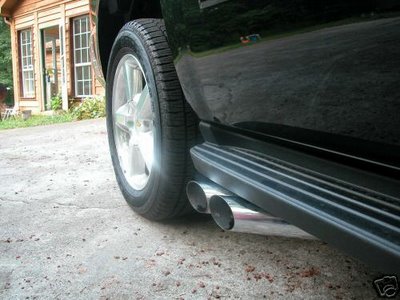

Yeah the g wagon looks dope with it and yeah I agree exhaust fumes might be bad when windows are down. I found a random pic of a Tahoe with it in my phone.

That’s exactly what I was looking for. I wonder if that is true dual or a dual tip. I want them to exit the same side like that but not sure I want to modify the entire exhaust. Thanks guys. Oh, and what’s a game wagon?

Think over time heat from the tips would distort the running boards? They are only plastic.
I would think so too
PG01
Nov 6, 2016
15,686
21,099
Up here to the right
So is my back bumper/quarter panel.....NNBS... i know its further back but mines about 1/4-1/2” away and no probs
52,949
The exhaust tips don't get hot, they're too far back. Go check it out next time after driving. Pretty warm, yes, but not hot.
