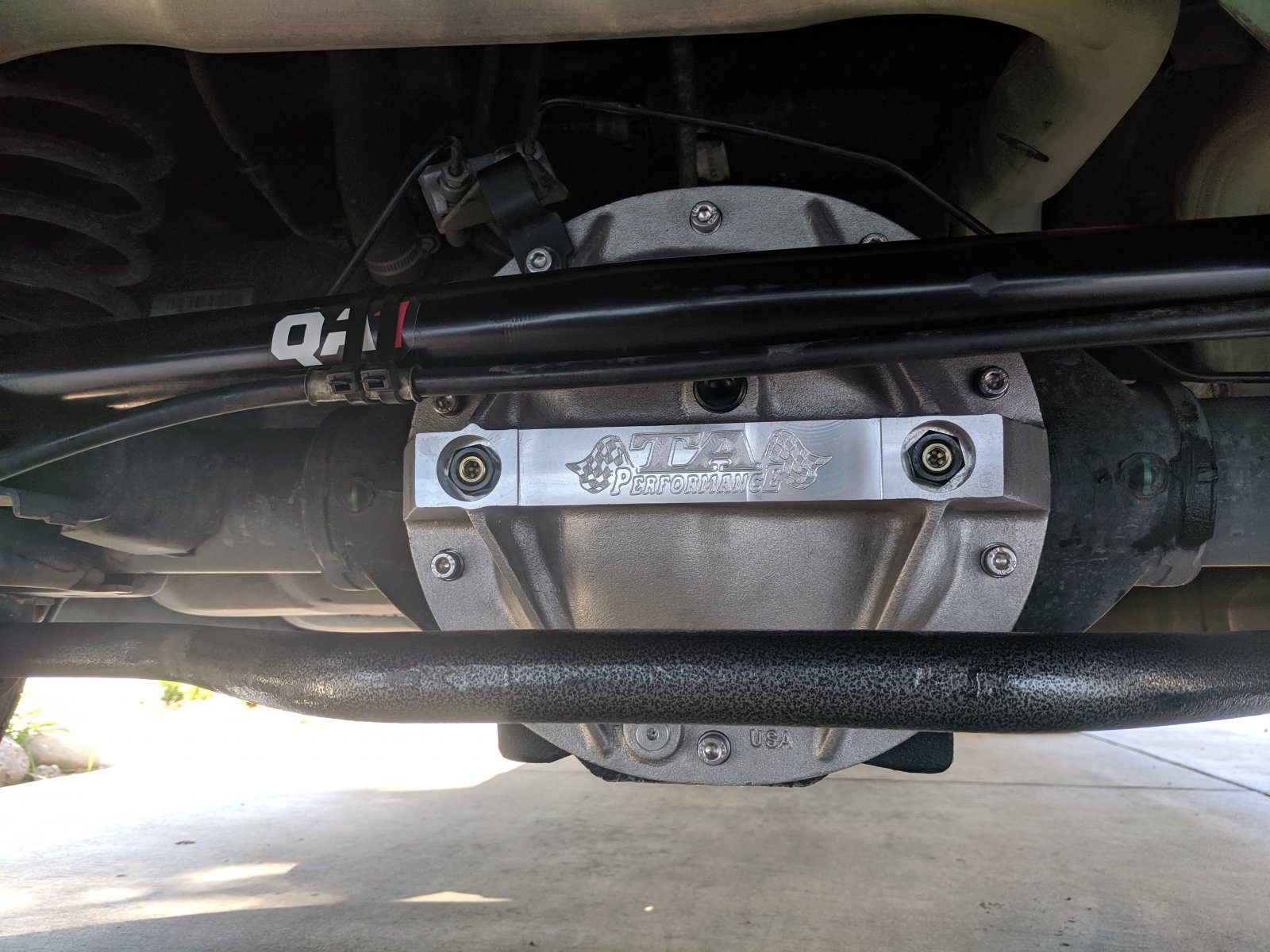

the ta performance rear diff girdle and a QA1 panhard bar will fit, I also put spohn boxed lower control arms and mevotech upper control arms, hellwig sway bars front and rear.
if (when) the G80 goes out then I will put in a Eaton Detroit.

I tried the TA rear diff girdle/cover and could NOT make it fit with
panhard bar/ Etc...
I took my cover off, spare tire,, etc and did everything I could to try to
get it to fit with No success , so I sent it back.

the TA wont fit with the factory panhard but will with a QA1 (just barely)

Doubelieve, That looks really good... I just could not make it work with
the factory panhard.
I'll look into the QA1. They make pretty good stuff.

5262, nevermind the years it shows compatibility with if it fits a 08 it will fit a 14, worked on my 2012
you will just have to use some big zipties for the parking brake cable, they have held up fine.
If I remember correctly it was a little hard to fit in the slots where the bolts go through on the ends but do-able, I think I used the factory bottle jack under the axle and played with it a little to get it in but it worked out fine.
