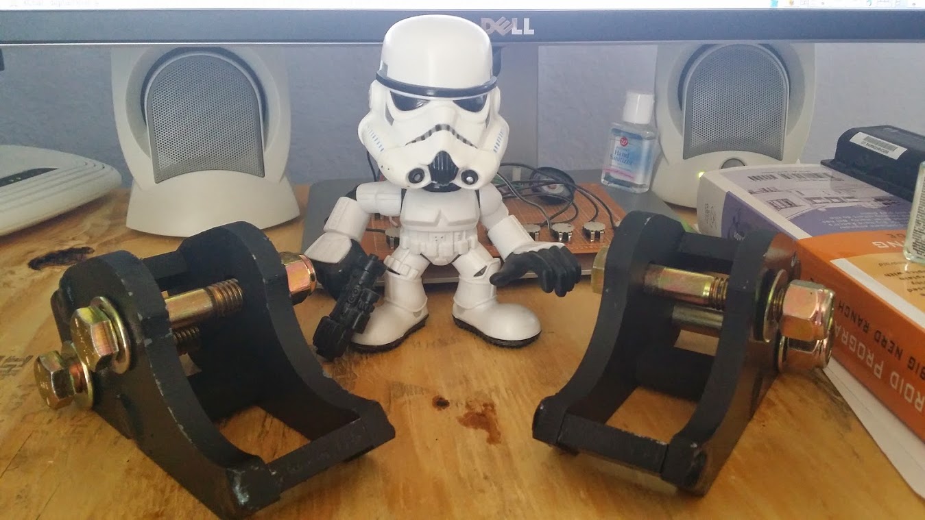

I got my lowers today. These things are built to last. If the need arises I'll use them to flog people until I get my QA1's ordered. You sir, Mr. Atomic, have greatly pleased Mr. StormTrooper:

Must have Storm Trooper. That is awesome.
The uppers are just as nice.
Got my brackets as well, car ****!! Very nice piece can't wait to get them installed.
