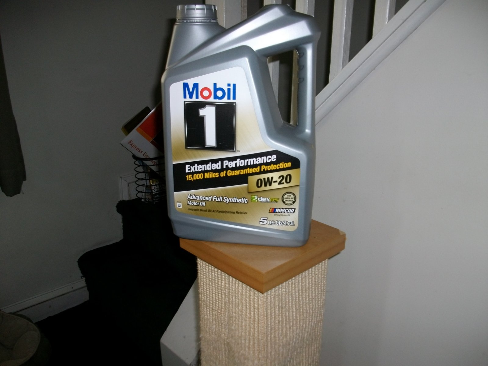

For what's worth, Mine does the same thing, but you have to keep in mind that you have 0W/20 motor oil. So long as you use a top brand oil, (I use Mobil-I ? ) but that is DEXO'S approved specs . So ?

Makes that noise using 0w20 Mobil 1 EP or 0w20 AC Delco.
The stupid dealer by mistake [Schumacher Chevrolet in Palm Beach Florida] put 5w30 in by mistake awhile back. The noise was much worse until I took it out a week later and put 0w20 back in it.
