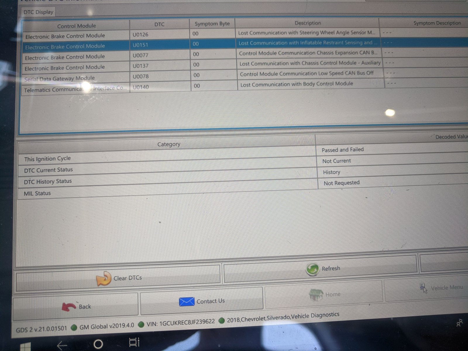

I have some questions regarding can bus errors that keep popping up and communication errors
if anyone is interested I am trying to narrow the problem down to either the BCM or can-bus communications or both.
on my 2018 Silverado I get
radio codes only no HMI codes
u0028 most bus
u0140 lost communication with bcm
u0164 lost communication hvac
b1325 high voltage
ebcm codes
u0126 lost communication steering wheel angle sensor
u0151 lost communication inflatable restraint system
u0077 control module communication can-bus
I can clear all the codes from history, sit there and scan it on the same session and get no codes
drive it a little bit turn it on /off scan again
little by little within a few minutes the codes creep back one or two at time
all will come up as either history or passed and failed
no open code

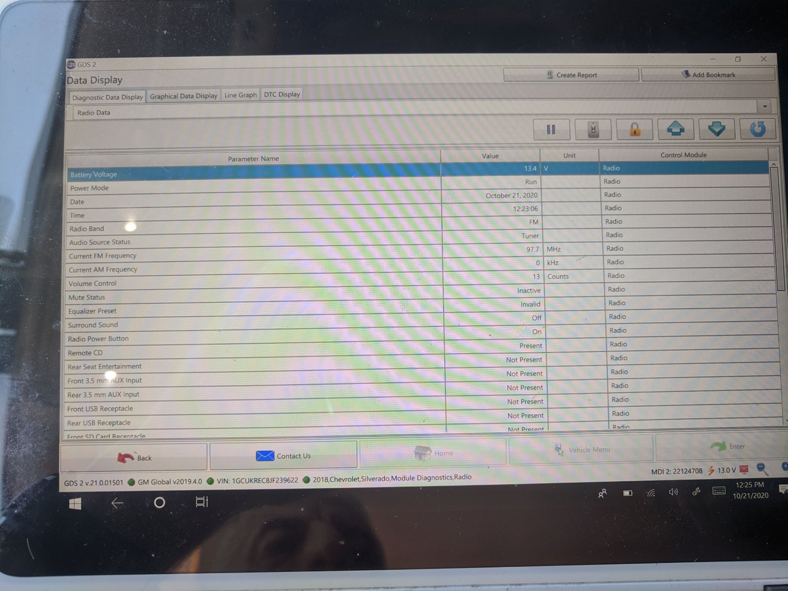

on different sessions I loose complete communication with radio and most of the modules, while those communications are down the ebcm is flagged and serial data gateway module is flagged, hmi is green, bcm is green and power steering control & transfer case module is green
the dealer is hesitant to do anything because i have aftermarket equipment installed such as a alarm system, hid lights, led lights
here are a couple photo's showing how I get intermittent communication, works and then it doesn't work
vehicle has no cel, drives and runs great, radio gives me intermittent problems, but these other codes are unrelated and should not even be coming up

just a update to this thread, discovered the alternator was defective and was sending voltage spikes to the bcm causing the ignition to restart, this caused multiple modules to have a bad handshake, problem seems to be resolved with a new alternator.
