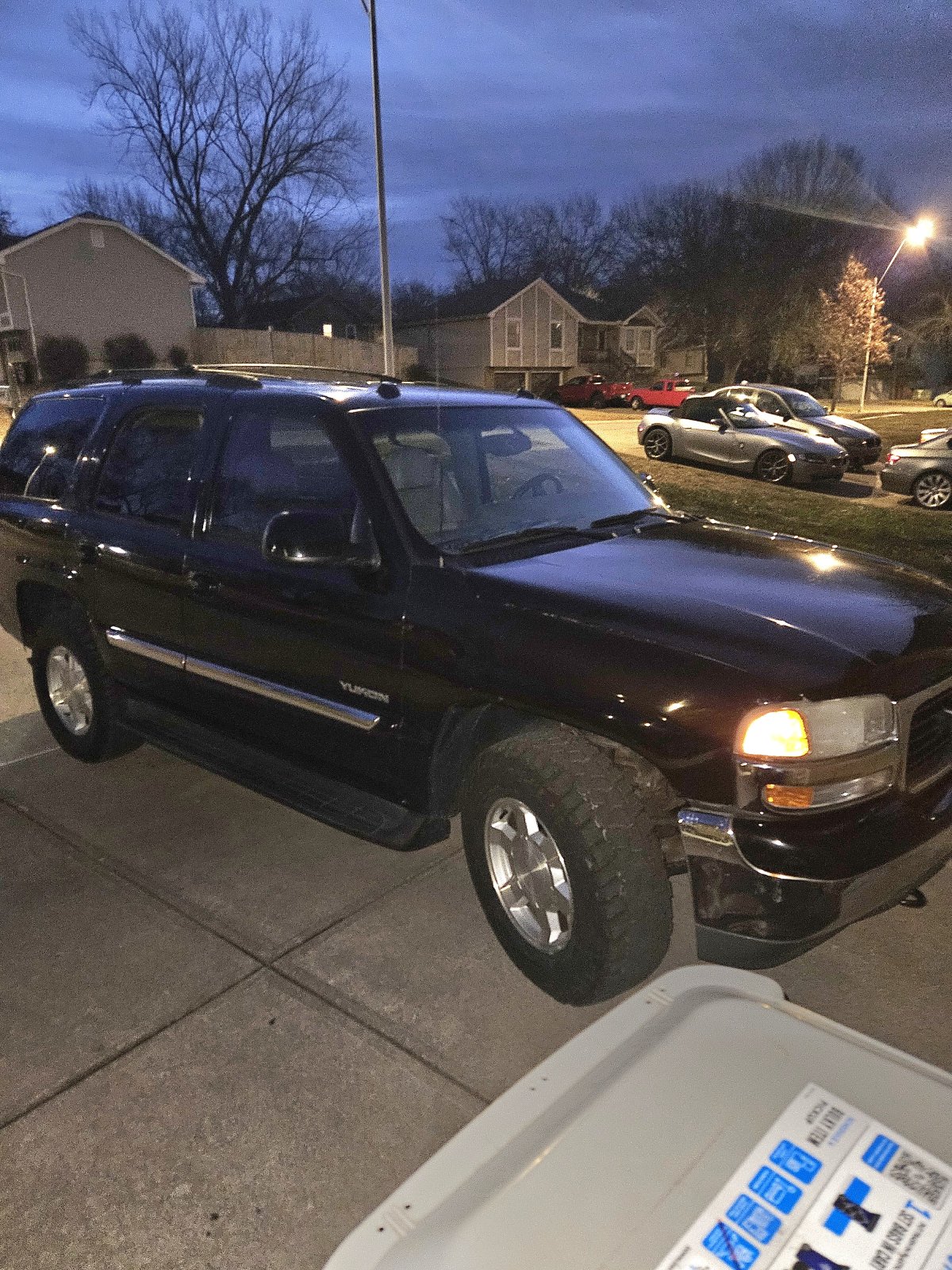

2004 Yuk SLT. Scratch'n 300K! Only minor repairs & routine maintenance. Drive it everyday still looks respectable.

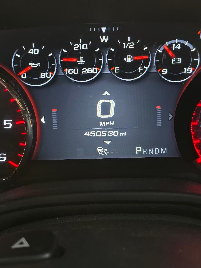

Hi Guys, Just my 2 cents here: Mine is a 2015 Denali, and I just past 450K miles. Its my daily driver. I do all of my own work, so that really helps. Thanks,

@tuffguy23 Thats impressive.
Give us some more details:
Original engine and transmission?
Do you have the 6 speed or the 8 speed transmission?
How often are you changing your transmission fluid & filter?
Engine oil change intervals?
Have you had to replace any major drivetrain parts? Differentials, transfer case, etc?
Steering gear assembly?
How is the interior and electronic features holding up?
Buttons, switches, door handles?
Power window motors/regulators?
Driver assist alert sensors (audio & vibration) in drivers seat and otherwise?
HUD still work?
Have you had to replace any HVAC actuators or blend doors?
Is there anything that doesn’t work anymore and parts are discontinued?
Have you been replacing parts with mostly OEM or aftermarket?
Anything else major or annoying repair that you thought would be simple that turned into more than it should have worth sharing?
Sorry for all the questions, but your mileage is impressive and many owners/members could benefit from knowing more details about your experience and best practices on how you got there and are still going!

Hi again: Well yes, original engine and 8L90 trans. I've done lots of maintenance and work on it. I have replaced the cam and lifters twice: at 206K and at 440K miles. The transmission gets new filter and fluid every 12 months. The thermostat bypass keeps the ATF cool, under 150F. lots of smaller repairs but the axles, diffs, and transfer case are good. Everything works. I just added a catch can. Very surprised at the amount of oil it catches: about an ounce or so every 1K miles. just gotta keep on top of things and fix them as needed. Oil changes were every 5K with 0W-20. But i realize it needs thicker viscosity to protect the cam. just my opinion. now using 0W-40 every 4K miles.

That is impressive! Well done. I have 184k on the same drivetrain, but 450k is a whole new level. What transmission t-stat bypass kit did you use? I love the 8 speed and have found it to be quite durable with proactive fluid / filter changes.

Thank you, I used the Superior STL010 bypass kit. Seems to be a good upgrade. Also the K&N catch can kit is very high quality and easy to install using factory style hose connections. Good Luck.
