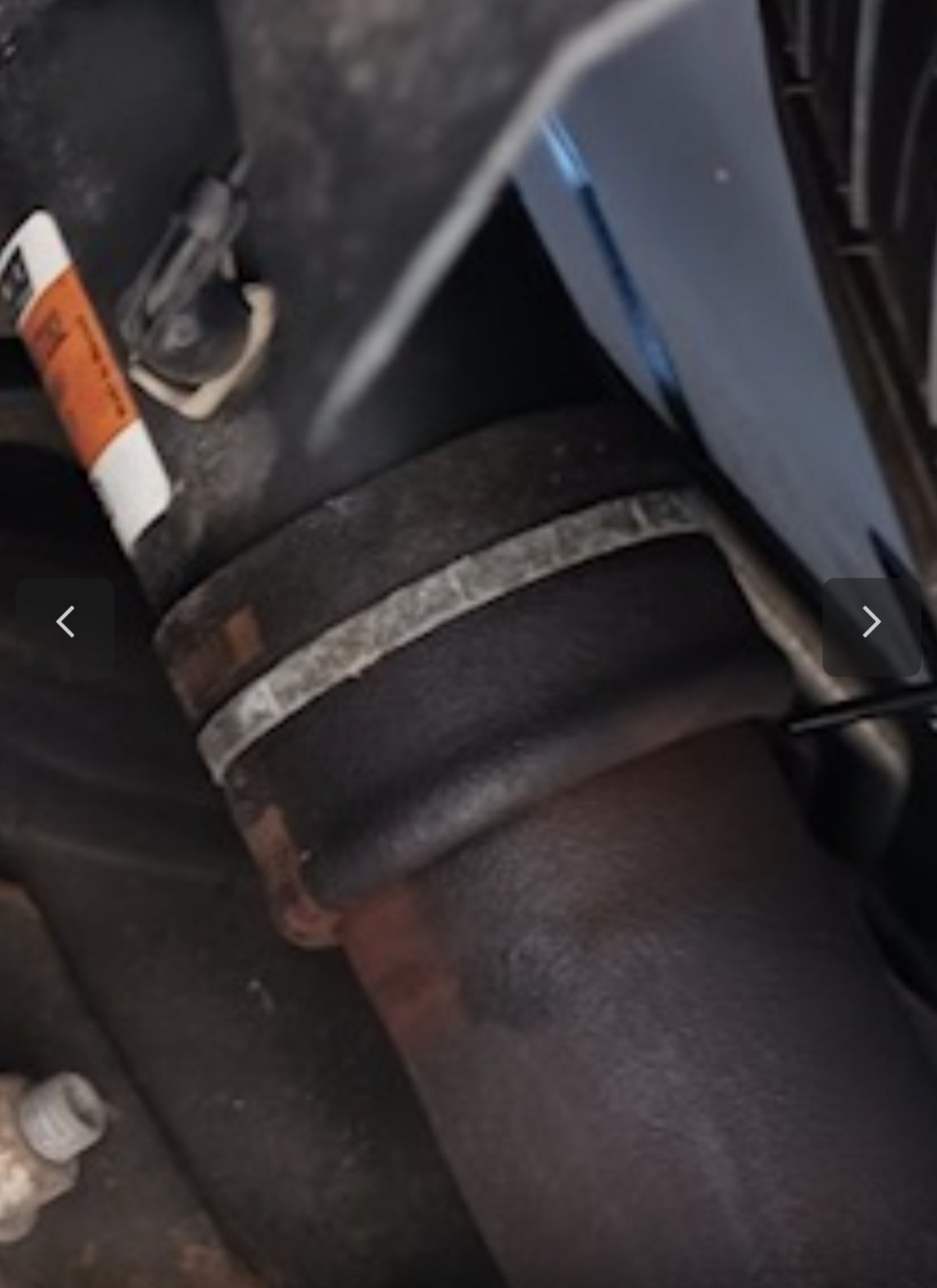

By looking at the air shock I can say the air compressor is shot. The shocks might be aswell, the air bladder is not supposed to be inside it self like the picture you posted.

I'm staring hard at those pics and don't see the crack.... this is why I love this forum. Nothing gets by you guys!
they are all cracked with VERY few exceptions, nothing to worry about it's one of the very few defaults with this generation
