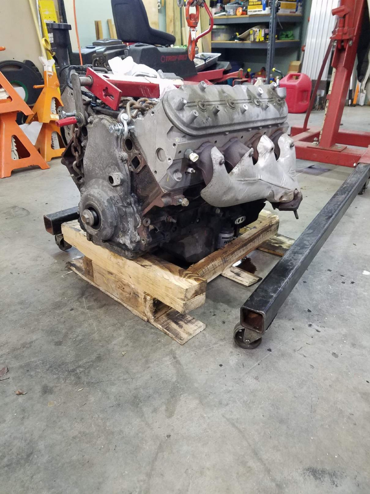

So a pretty dark day for me. I just showed up at the tuner because they weren't being very responsive over the phone. They told me the truck was almost done but that the right side catalytic converter was "pretty clogged" and I needed to be careful driving it so it didn't overheat that on my way home. I left their lot with it feeling funky and only got about half a mile before the truck shut down.
After sitting in the cold for a while and waiting for them to call me back with some kind of explanation and solution I started it again to see if I could limp it home in chunks to get at the cats myself.
It drove a bit farther and I noticed I had the oil pressure nearly pegged. ?? Shortly after that, ripping along at 20 mph with bad noises I looked again and my oil pressure was sitting on zero. Shit! I shut it down again and coasted to the safest spot I could find and checked the oil. Gone. Nothing on the dipstick and smoke coming out of the tube. WTF!
I finally called AAA to get me home and sat on the road for almost 3 hours waiting for them. Some amazing people asked if I was okay and half kidding I told one guy I could use some oil. He pulled over and pulled out a jug and funnel and we poured some in. Now on the dipstick I started it again to find no oil pressure. I let it run a few seconds knowing it could take a bit to prime the system. Still nothing so I shut it down.
Eventually the AAA app on my phone said the truck was there except it wasn't. I waited a while longer and fearing the truck had gone up a driveway and wss hooking up someone else's white Tahoe I dialed AAA and sat on hold a couple more minutes. Just as I got a person I saw the truck. Nice driver got my Tahoe home. It's in the garage waiting for me to figure out what all is wrong now. Oh yeah, sitting on the road with the radio and flashers on the battery died completely so i didn't even have flashers.

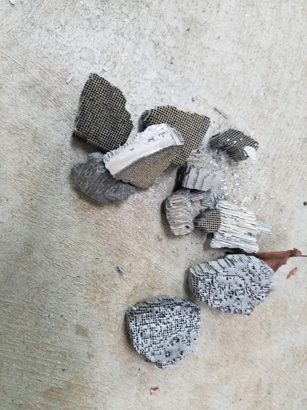

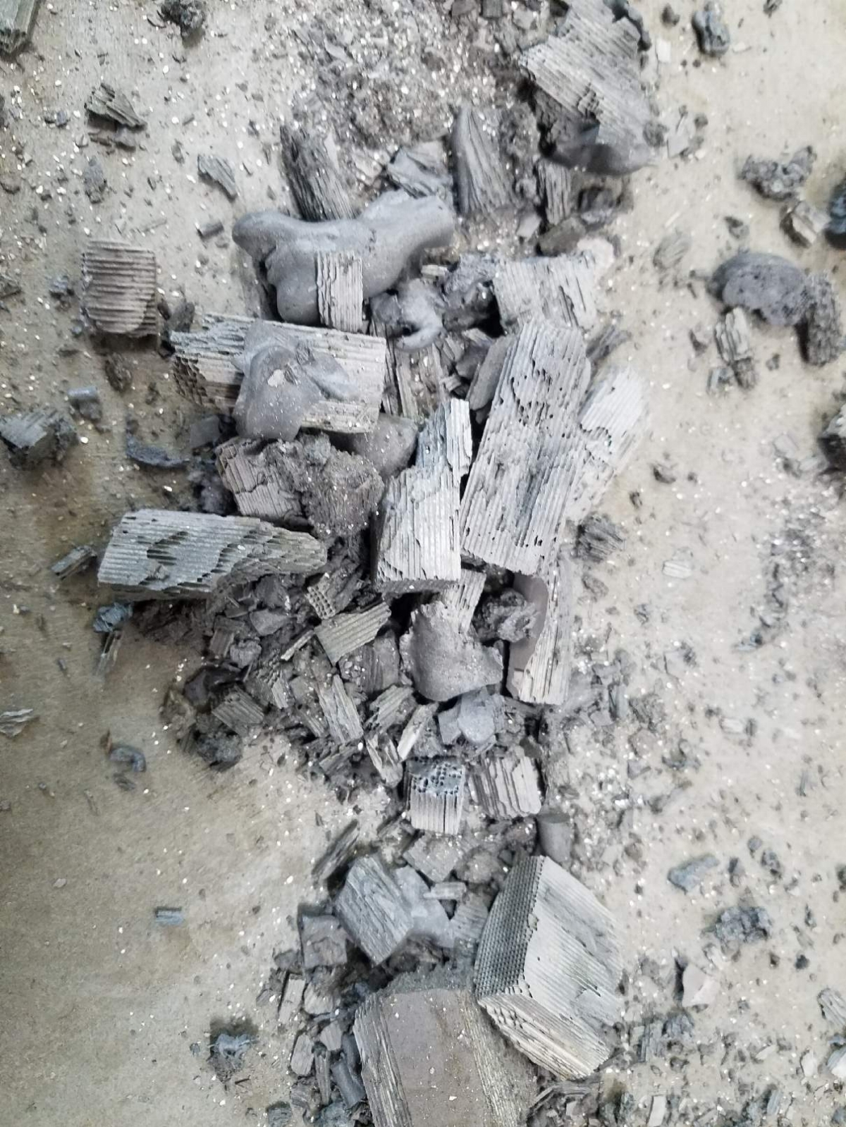

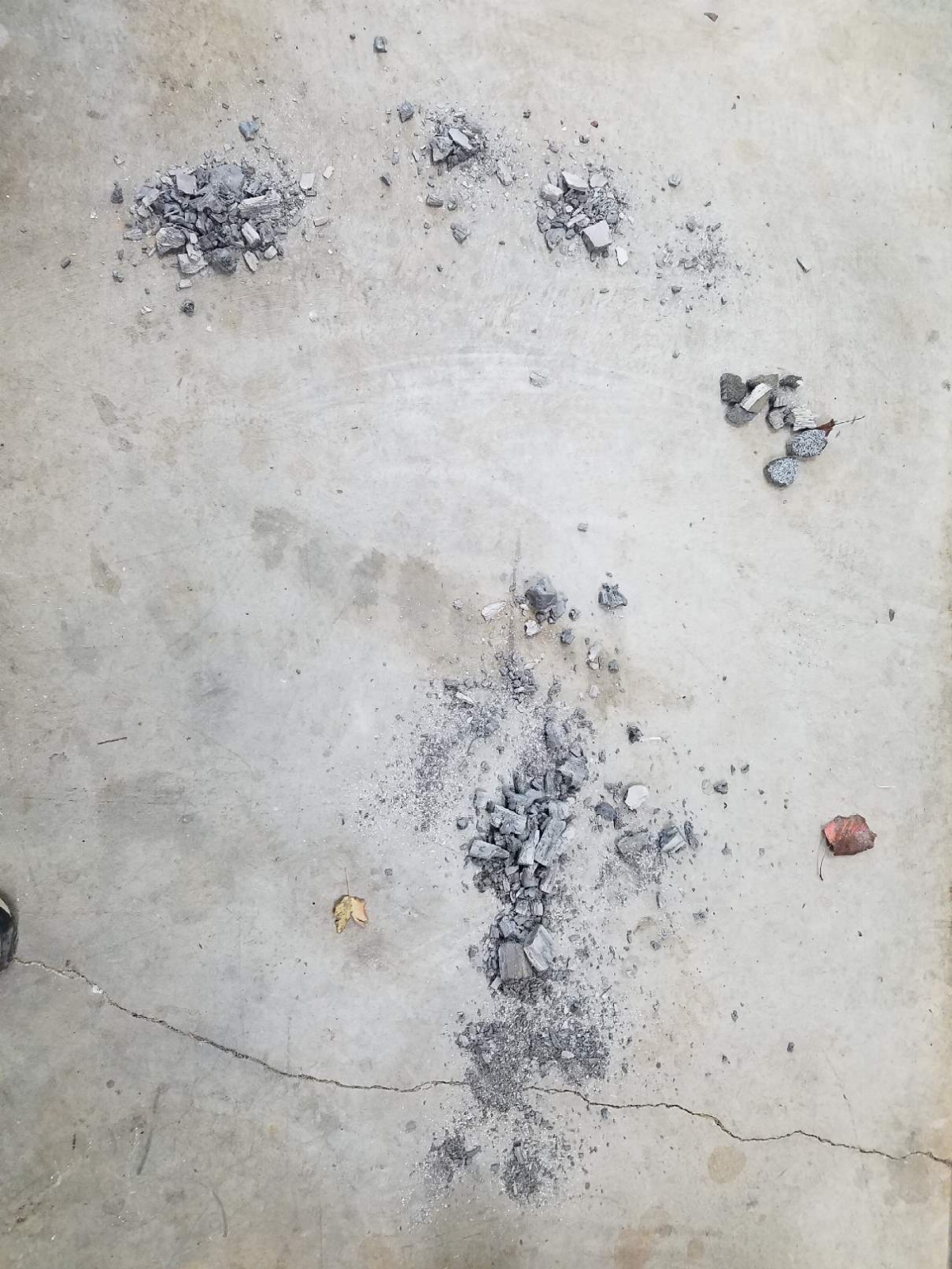

Getting the Y pipe out is a pain. I had to drop the sway bar down and support the transmission and transfer case while I dropped the transmission support. As I was getting the pipe down I could hear something rattling inside. I thought maybe I found the nut I lost before.
When I pulled the pipe out from under the car I could see right away there were issues with the catalysts on both sides. I tipped it up to dump the nut out. Um...
This stuff poured out.
Closer look you start to see some structure.
Yep. That used to be the honeycomb catalyst. Note that I didn't break these up. Both sides were shattered into crumbs and were blocking the pipe. I ordered the new Y pipe before I took this out but it'll be days before it comes. Meanwhile I'm going to finish hollowing this pipe out and put it back in place to examine what I did to the engine.
I've got this lump sitting in my basement. I have to figure out what I'll do with it.
Having seen the blockage I now have a better understanding of what happened to my old engine. The AFM might not be the culprit. The blockage pressurized the block and blew the oil out any way it could. That turned out to be into the intake manifold where it exacerbated the issue by further blocking the catalyst.
