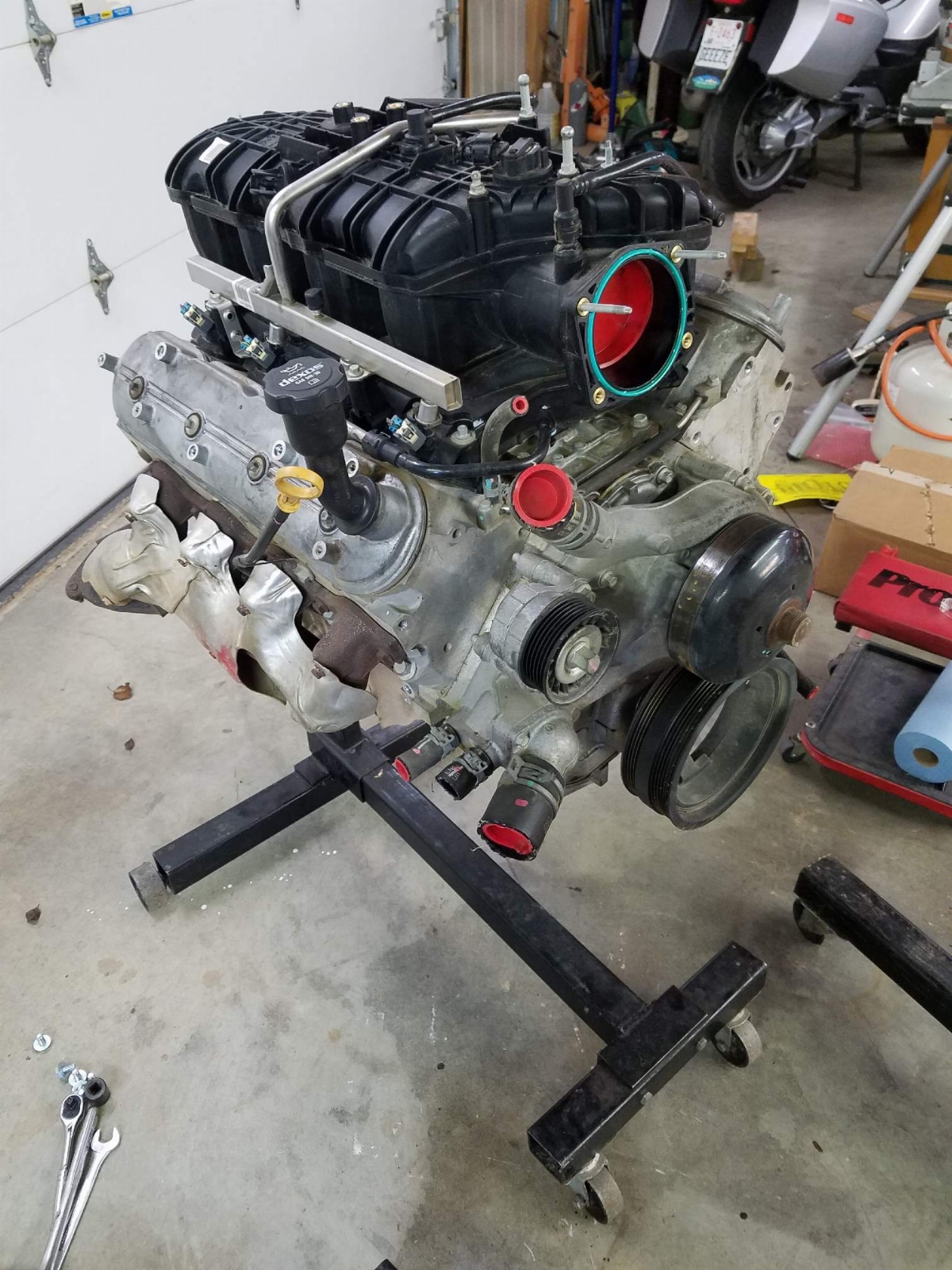

Meanwhile, pics or it didn't happen;
The new engine

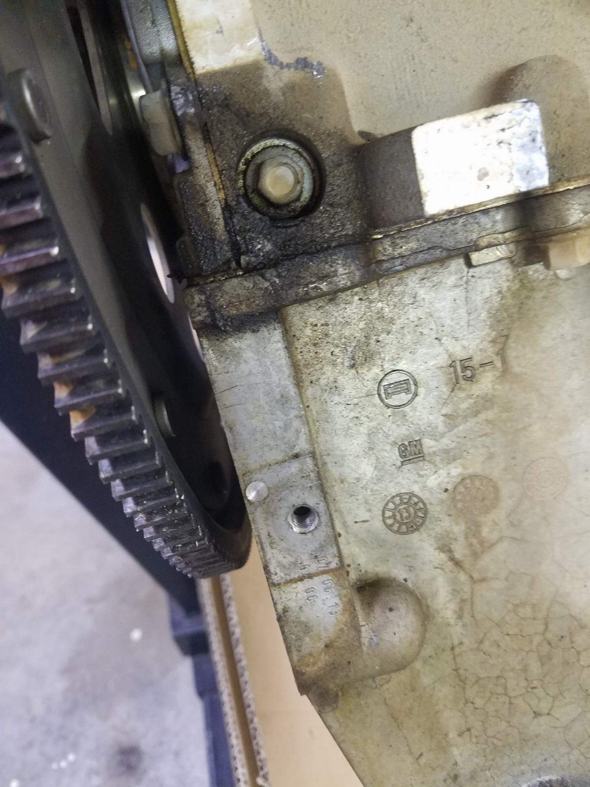

There are a few oil leaks. This at the right rear bottom of the block. Somebody please tell me what this is and what I need to do to fix it.

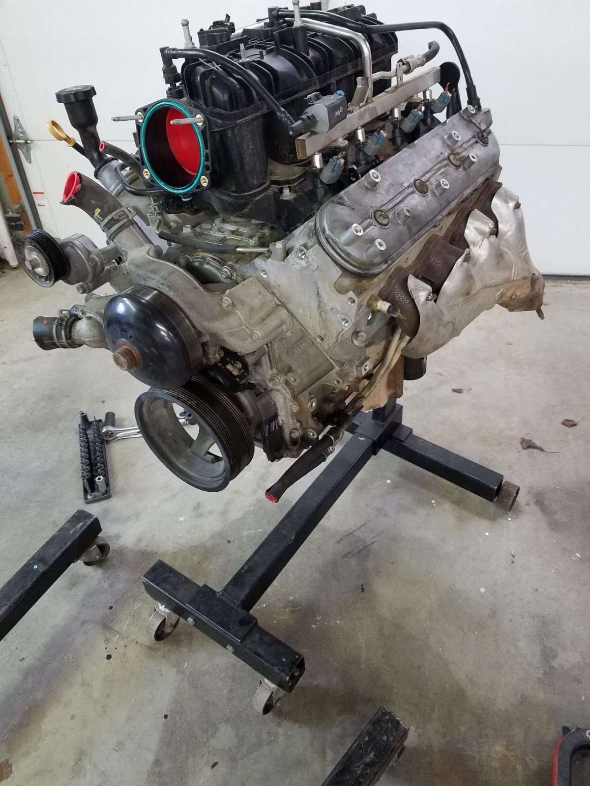

Some old spray around the crank pulley

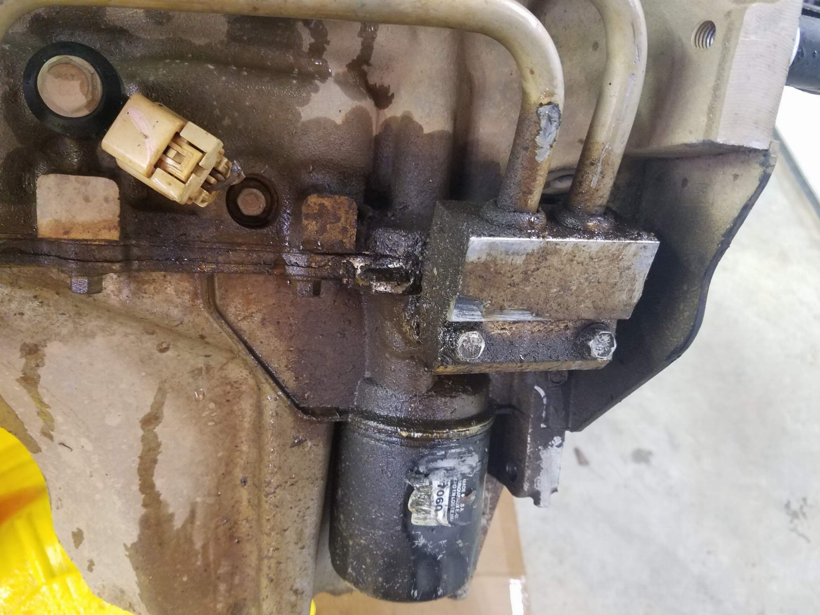

This is really messy down here.

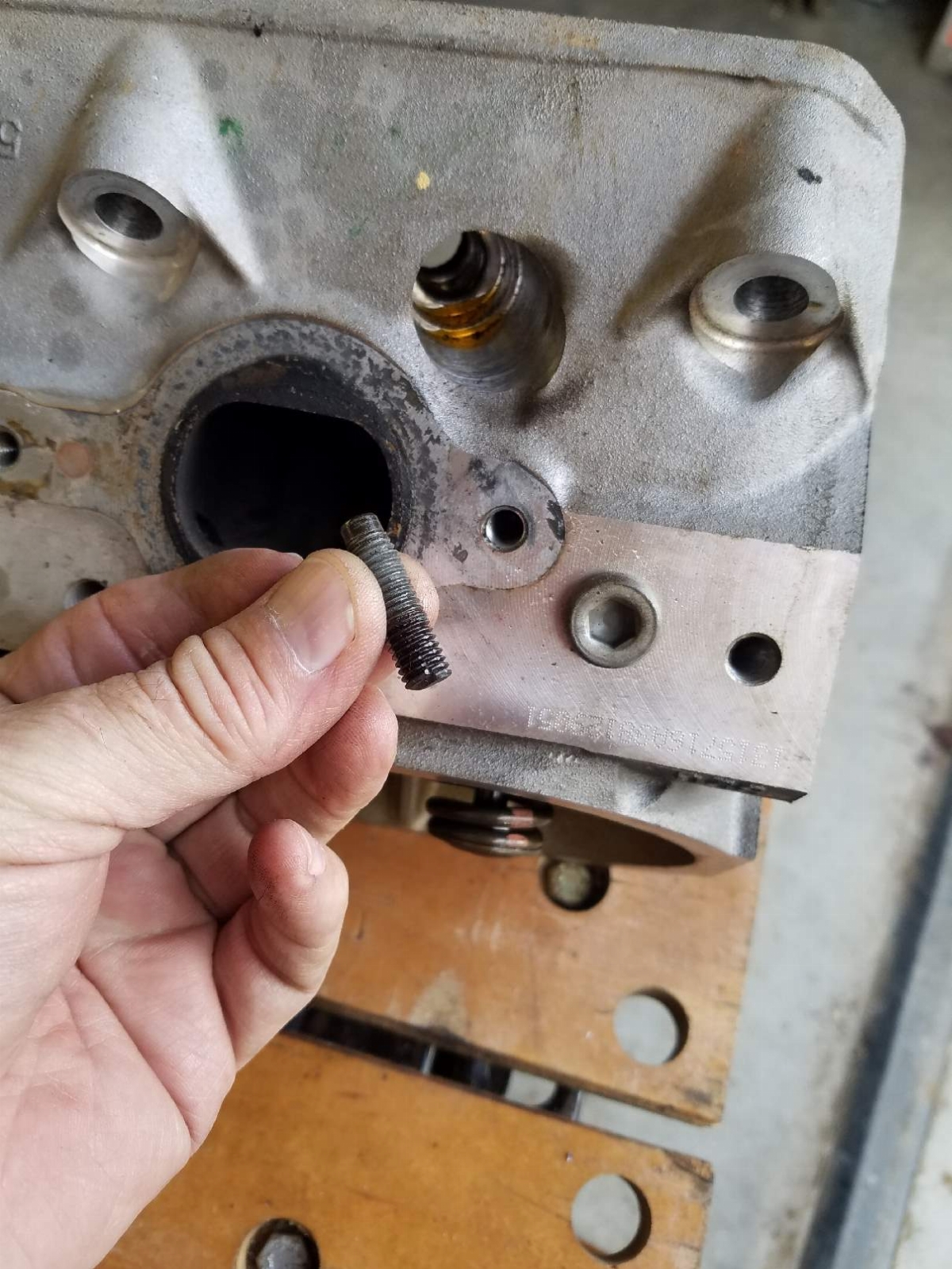

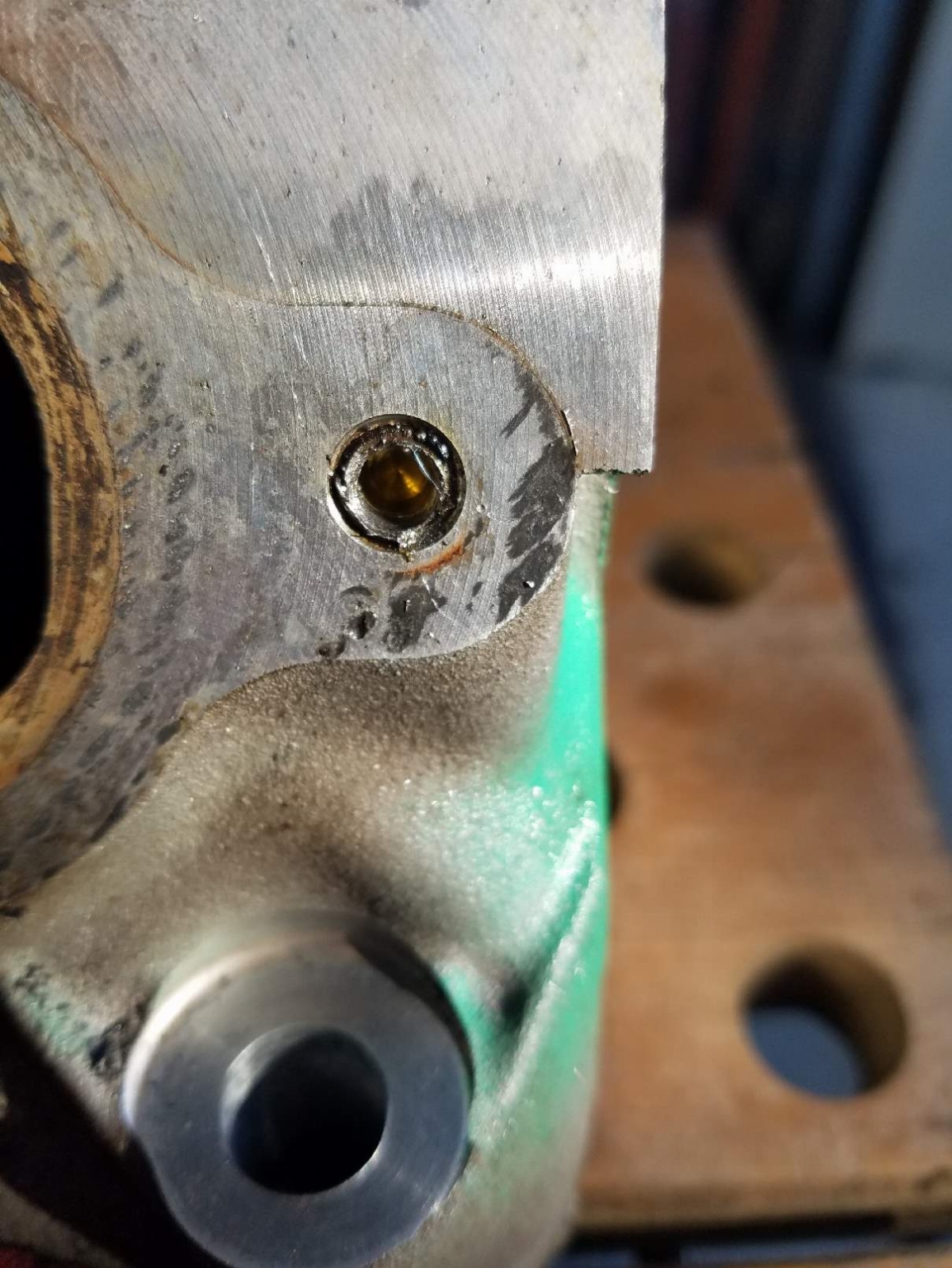

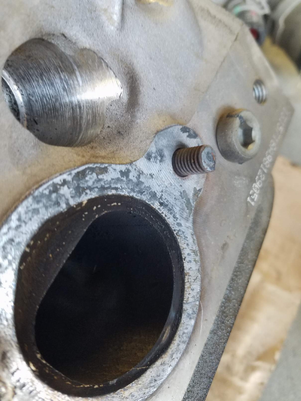

Made some progress yesterday. First some mundane things to deal with;

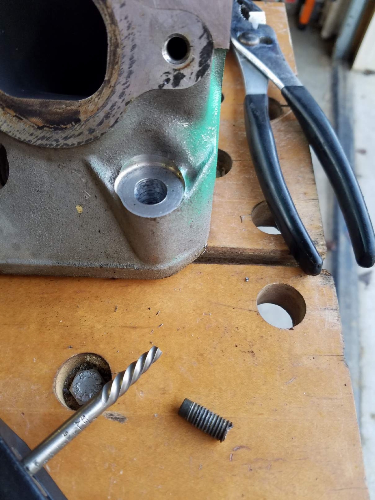

Broken exhaust bolt standing up for easy removal. Heat, penetrating oil, and a couple smacks with a hammer had this one ready to just pull out with vice grips.
This one was flush with the deck and had to be drilled, heated, penetrated, hammered, and finally extracted with a screw extractor.

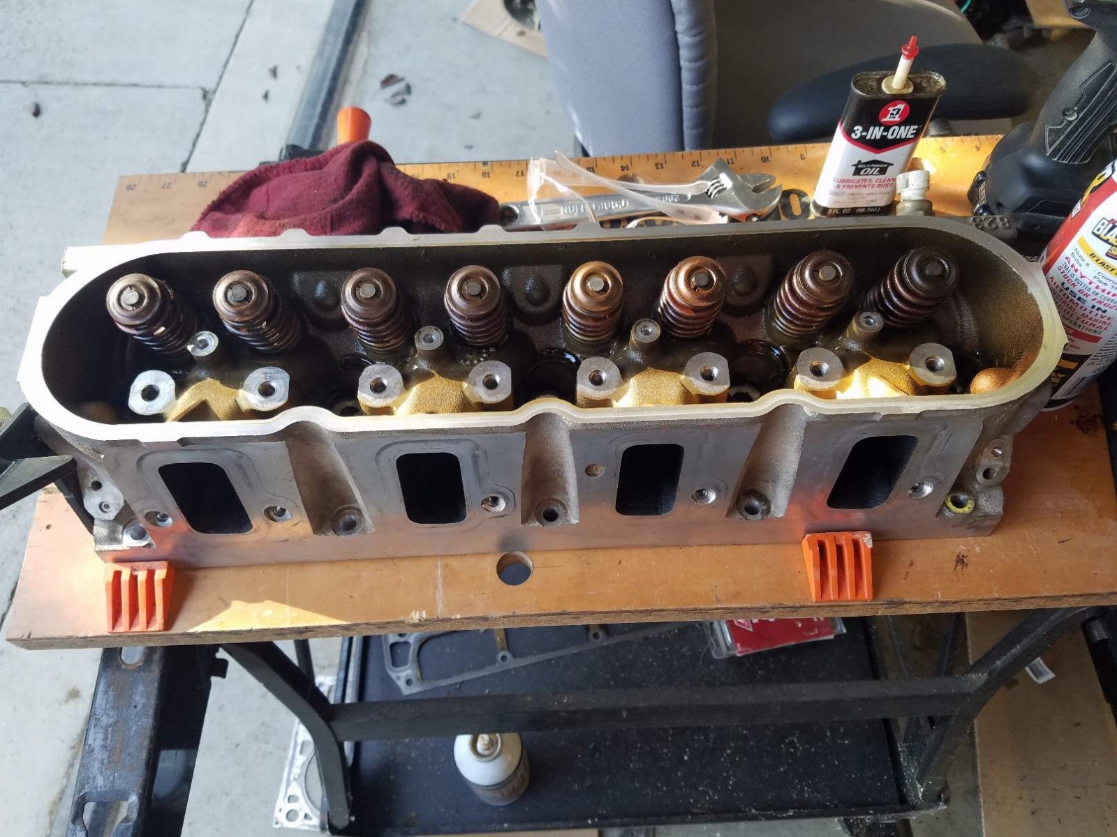

Oddly I wasn't prepared for how light these cylinder heads are.

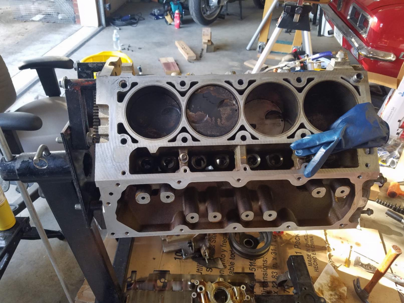

Block is nearly ready for final cleaning and then assembly. I managed to pull the harmonic balancer with an antique two jaw puller by using a combination of flat pry bars for the jaws to latch onto behind the pulley.

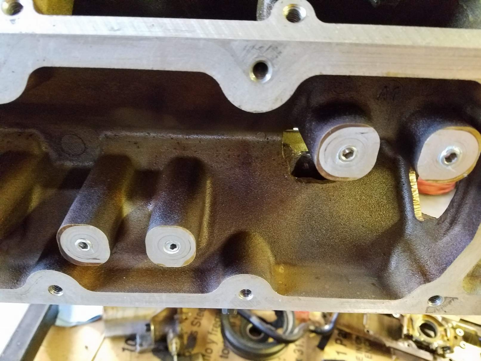

And finally the AFM oil towers plugged.
