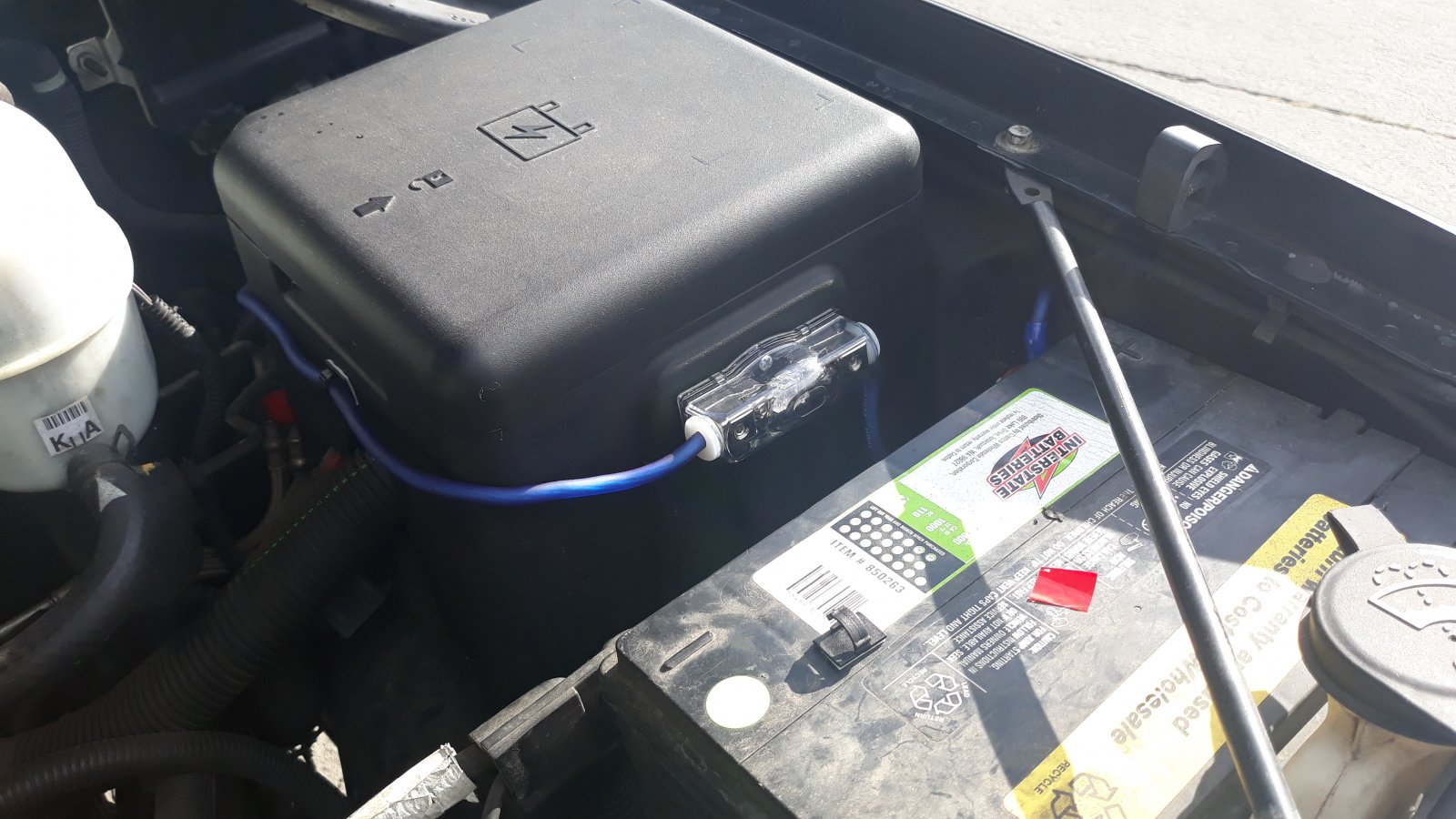

I believe that @Doubeleive gave you a great roadmap for the installation of the electrical portion of your audio system upgrade.
On my NNBS, I installed the main fuse on the firewall, coming out of the input side of the truck's main fuse, coming off the battery.
