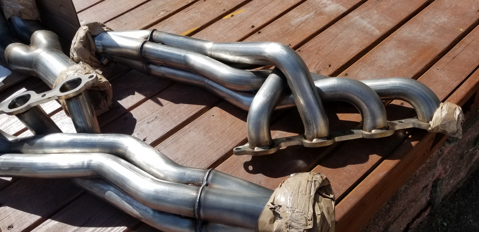

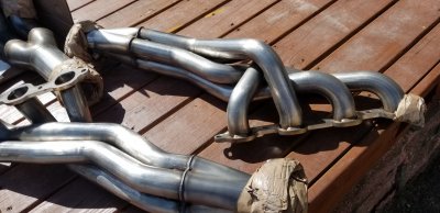

A little late to the discussion but I ceramic coated the AR headers that I picked up less than 2 months ago. They came our great and run a bit cooler just like the headers on the rest of my rides.

Well better late than never? I just got mine myself and have been debating to get them coated. Who did you have due them and what did it run? I been talking with jet hot about doing them just haven't decided yet. Cant get anyone with any good feedback.

I had mine coated by Excel Coatings in Port Canaveral Florida. Actually this is the 3rd set of headers that I've had them do for me. They do great work. Took them about 2 weeks which was fine for me. I dropped them off before I returned to my travel assignment then picked them up about a month later when I came back on one of my return trips.
I had another 3 sets of headers (2 mine and 1 for a friend) done in Wa state when I was living there. They all look fine and are functioning well / as expected. Maybe you can find someone local to you that does ceramic coating.

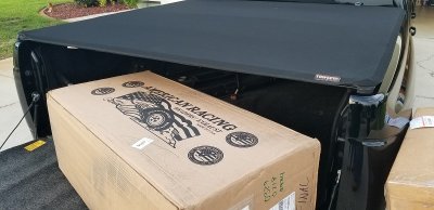

No sir, no problem at all. They charged me 400.00 to ceramic coat all of the parts. The box is bulky and a bit heavy. Maybe you can get them dropped shipped to save you on some of the shipping costs.
They are located in Port Canaveral , Fl. They do great work with the ceramic coating. Thanks.
