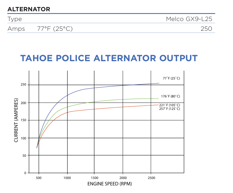

Going to make the jump to upgrade my alternator to higher output one and I want to stick with GM parts.
I have the 160 A 25877026.
The one I am considering is 13536552 which is supposedly 220 A.
I have also seen 84143539, but I think it is later model years?
Are either of these a direct plug-n-play for my 2009 5.3? If not, then what are some other GM alternators I should consider for about the same output of 220 A?
Do I need to do the big 3 upgrade, too? I am not running any high power audio.

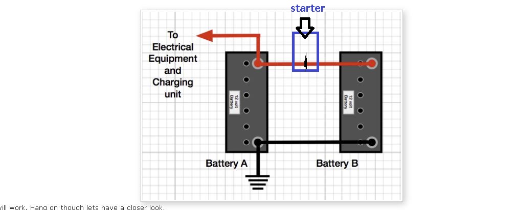

Can you run a second positive cable from the alternator to the Aux battery without causing any issues down the line?
I hope so. I was planning to run another cable as well.
The route it takes to charge the second battery is: Alt--> 175A fuse-> Batt1-> Starter-> Batt2.
Don't know if it matters or not, but considering extra alt cable and extra block-body-chassis grounds.
The proper method and how easy or hard that is to do is another thing
mine are connected in parallel like this, with both positive connected at the starter and battery A is connected to the alternator
according to this guy that works but is not really the 100% correct way, his drawing assumes there is nothing else connected, which is where the problem is.

Back to the alternator question...
From what I am understanding, the two GM alternators I am looking at should be drop in with the exception of the post might be a different size. Is there any reason why I should choose 13536552 over 84143539, and vice versa?
Are there other GM alternators that output about 220-250 A that I should consider for my 2009 5.3, and that will be mostly plug and play?
I am assuming with the higher out alternator I should consider upgrading cables to a larger size (big 3). But is that really necessary if I am not running high output audio equipment?
---220a reman
---220a reman
---220a reman
---this one is 215a tyc
https://www.rockauto.com/en/moreinfo.php?pk=8767580&cc=3307625&pt=2412 --oe 220a
