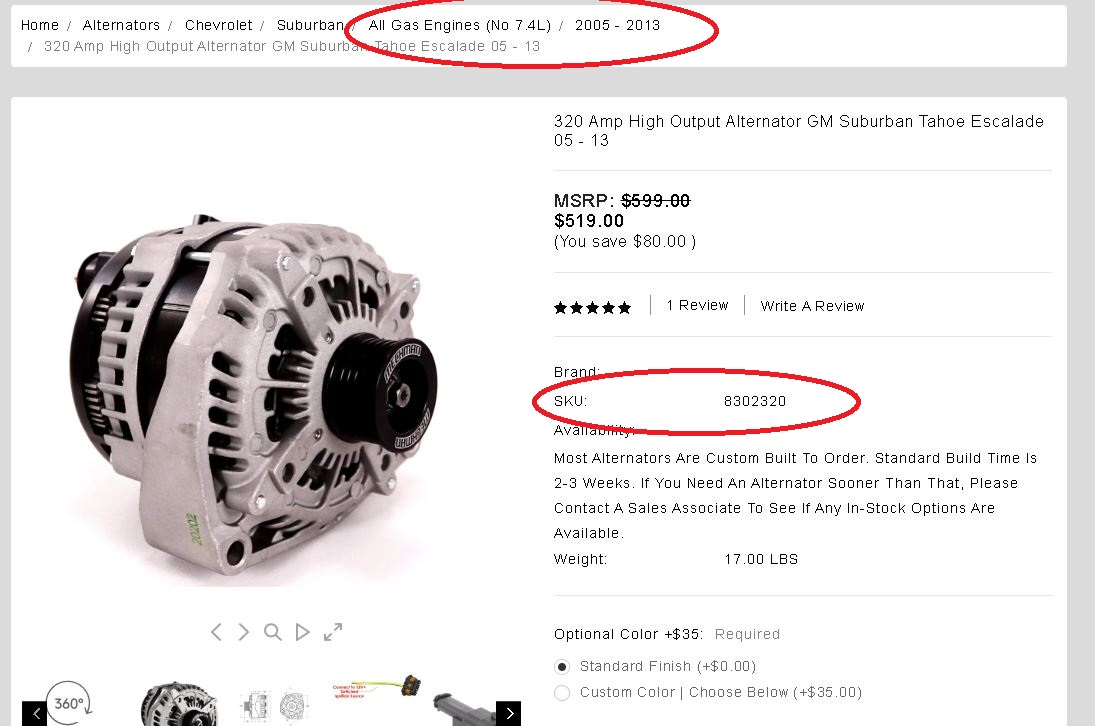

On that page for my model, I only see one that has a standard pulley and is only at 250 A.
That model number you gave is saying only 320 A. Just wondering if we are on the same page?
If so, where did you find the shorter belt required for the smaller pulley?

note in the photo below FITS ALL GAS ENGINES 05-13, model number is circled as well
the pulley is standard size
