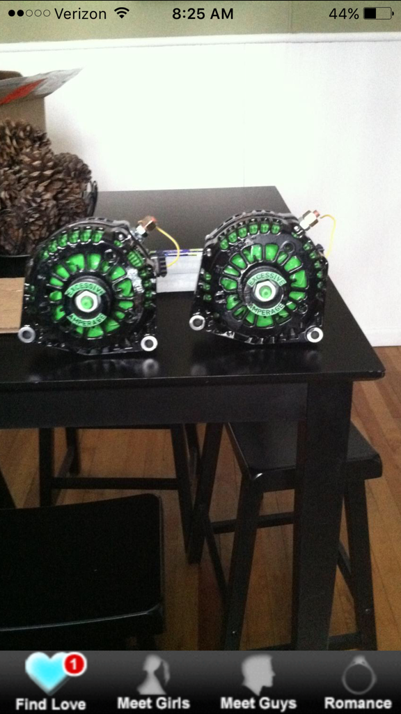

Contact excessive amperage for your alternator needs. I have four 350s alts from them.they can make you whatever size you want.

Lol just read your post about not wanting to go after market. Carry on
Edit: life time warranty on excessive amperage FYI
