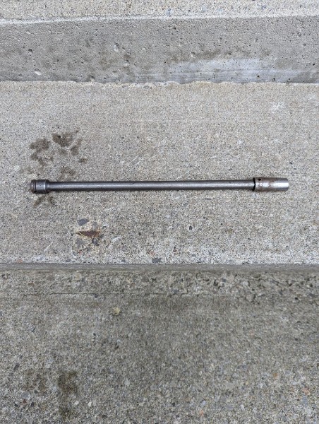

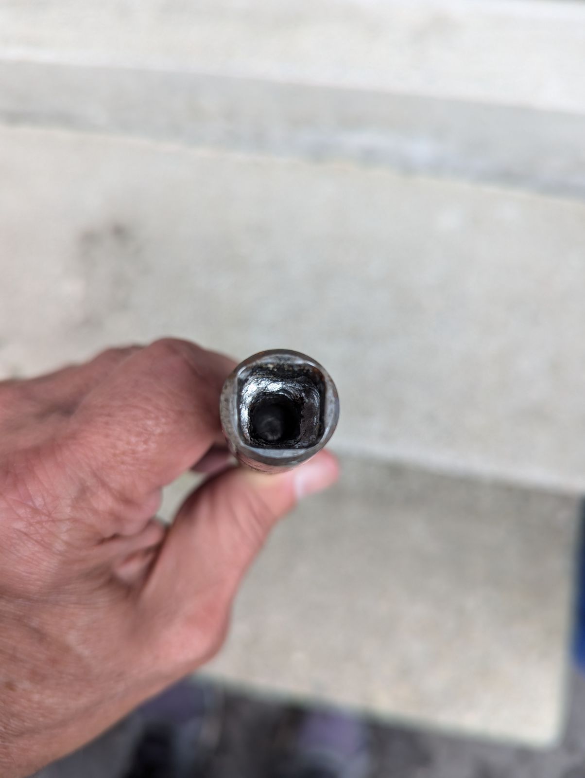

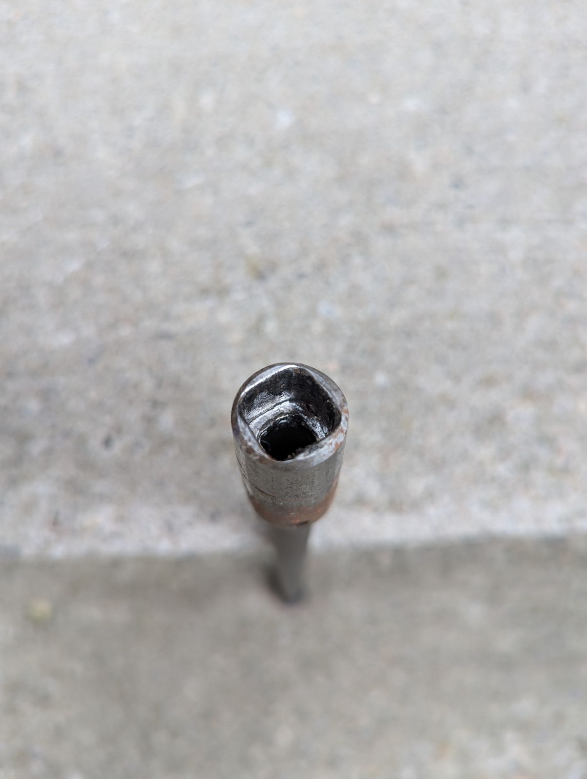

Hi there. I have a 2002 Yukon XL and after a while the cheap tubing that came with the truck in the tool kit wore out. The end that is supposed to be inserted so you can crank the tire down bulged until it just twisted. I looked at the end that was bulged out , kind of squeezed it back to its square shape and took a measurement of the inside dimension. i then found a socket that was just a bit smaller across that flats than the dimension of the old tube across its flats. Now mind you I have the tools and you may not but i used a small carbide burr to make a square hole and kept grinding until it fit. Also I used two Or is it three long extensions to insert it into the crank hole. I attached a ratchet to the end and it worked for me. It has never failed me since and that has bee at least ten years ago. i now keep those extensions and the ratchet where the tool kit was stored. This might not be the best method but it was the only one I could use at the time. I hope this helps in some way.
