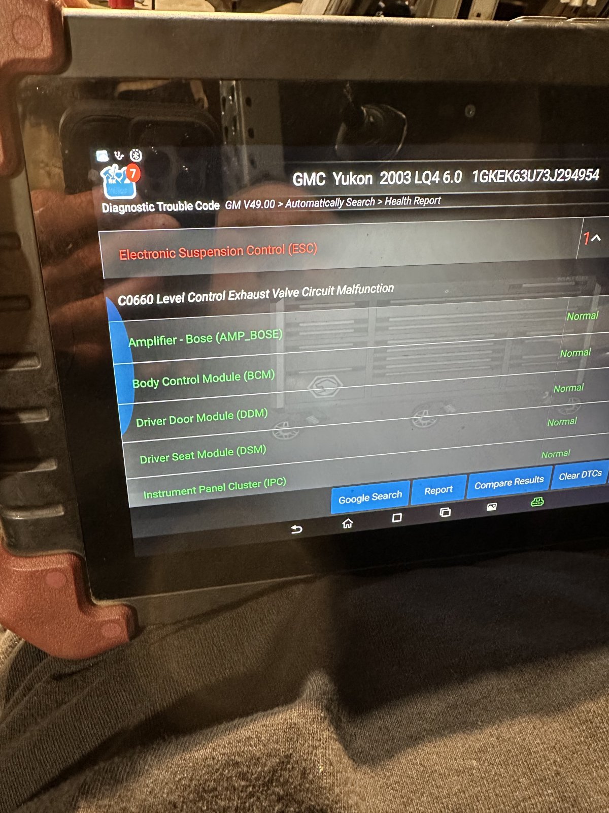

Been having intermittent issues with my air ride. Keep getting the service air ride message. Finally got this code What do?
10,284
14,891
That error is associated with your air compressor, part of the air suspension system. Before firing the parts cannon, do you hear the air compressor start up and run for 5 or so seconds, when you start up your truck? If yes, make a soap and water mix in a spray bottle and spray in on the rear shocks, both where the air line attaches to the shocks and on the rubber air bags. Do you see any bubbles, indicating an air leak? If you see air bubbles, then your shocks are leaking and need to be replaced.
If you do not hear the compressor start up, first check the fuse for the compressor in the fuse box in the engine well. If the fuse is good, you most likely need a replacement compressor. Rock Auto has Dorman air compressors for your truck for under $200.

Yeah I will occasionally hear the compressor. It was running after every start up before this all started. Now not as much.

Where is the air ride suspension module lol? I can’t find it anywhere on the truck or anywhere on Google. I replaced the compressor; checked lines. Had to jump the rely to get it to work. Need to replace the module but can’t locate it. :(
26,678
52,943
It’s behind the rear passenger side panel, you need to remove that big interior piece that covers the rear heater/AC assembly and you’ll see it.
26,678
52,943
Thank youuu
FYI those rarely go out, they’re a computer. More common is the ground wire being corroded on the compressor. It’s separate, it kind of branches off the wiring harness to a ring terminal on the frame. That was my problem after I installed a new compressor. The ring terminal wasn’t connected to the wire very good because of corrosion.
