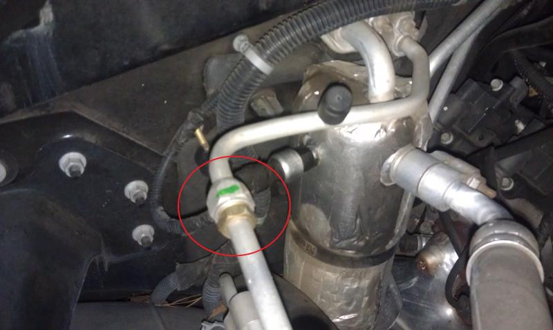

PAG oil is indeed designed to be used with R134A. The compressor will come with a precharge of PAG oil inside it so be careful to not pull the plugs from the rear of the compressor until AFTER unit is installed. Otherwise you will dump PAG oil all over yourself while installing. Read paperwork that comes with replacement compressor. It will note whether any additional PAG oil is needed to be charged into the system. If it is needed I just drop it in the hard line while I have it apart to replace the orifice tube. And for those that dont know the orifice tube is stupid easy to replace and MUST REPLACE when replacing ANY component that has refrigerant traveling through it, especially if a compressor throws its guts up which would would also require a complete system flush. The orifice tube is located on the hard line near the high side port. (passenger side of vehicle). There is a large fitting that you unscrew with a crescent or line wrench. Orifice tube will be in line forward (toward front bumper) of the fitting. Take a pair of need nose pliars and grab it and pull straight out toward firewall. Ill get some pics of the fitting when I can and add to here.
Circled in red is the fitting that has to be taken apart to access orifice tube and green arrow shows direction of removal. Use a backup wrench on brass fitting!

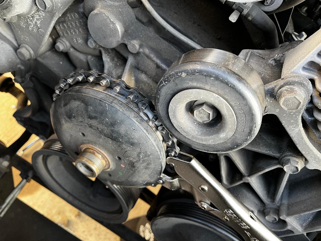

And, as a side note...I just replaced my compressor and tensioner pulley, and there was absolutely NO WAY it was coming out under the truck. Unlike every video I saw on youtube, there was just no pathway for it to exit! Too many lines and all the steering stuff. (And she's only a 2WD!!) I ended up taking off the fan, the shrouds and she came right up thru the front. I hadn't planned on doing all that, so I didn't order the tools. Went to O'
Reilly and rented a 36mm wrench and they didn't have the correct tool for the water pump pulley...so I improvised. Worked like a charm!
MassHoe04
Nov 4, 2021
1,588
2,842
Western MA
And, as a side note...I just replaced my compressor and tensioner pulley, and there was absolutely NO WAY it was coming out under the truck. Unlike every video I saw on youtube, there was just no pathway for it to exit! Too many lines and all the steering stuff. (And she's only a 2WD!!) I ended up taking off the fan, the shrouds and she came right up thru the front. I hadn't planned on doing all that, so I didn't order the tools. Went to O'View attachment 371000Reilly and rented a 36mm wrench and they didn't have the correct tool for the water pump pulley...so I improvised. Worked like a charm!
That there is GENIUS at work! That is an amazing solution!!! Makes job easy, tool is inexpensive and works.
First and last one I did one was my 05 Jeep 4.0L. I managed to take a pry bar and wedge it in between the inside of the pulley and the housing. Just enough pressure to keep it from spinning while I spun the fan clutch off. Your method is a little less risky.
I plan on buying one of those vice grips soon, just to have on hand. I could have used it on my last oil change (PO really cranked it on there).
Thanks for this idea!
