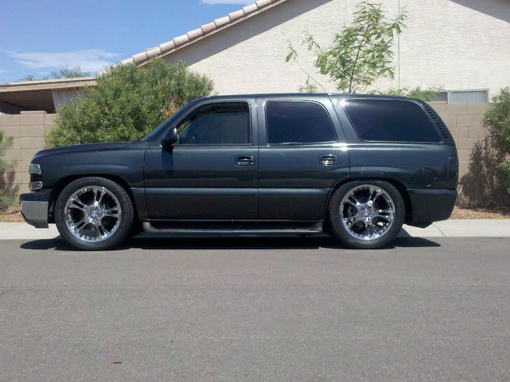

Here's my question. I picked up the Tahoe today from my buddy who bagged the rear.... we are using 2600 Dominator bags and the passenger side bag is only about 1'' from the exhaust pipe, is this OK? My buddy usually does hydraulics and is not sure if the bag will be ok or if it will get too hot, he said I should probably move my exhaust but I only want to if I have to since I just dropped all the scrilla on the bags.... So, anyone running bags really close to the exhaust? It is not touching and I don't think there is a chance of it touching but it is damn close. It is probably between .5'' and 1'' from the pipe......

the exhaust doesn't get that hot back there. but i wouldn't chance it. when i do mine i will have the exhaust moved.
Yeah.... I will do the same I just can't do it right away. I am going to get some heat shield today and wrap the exhaust next to the bag.....

yea im not sure. But i would hate for you to find out for us. Heat wrap sounds like a good plan, i would just keep a good eye on it for now.
Word up to that Trick...... I ain't trying to the TyBardy test pilot on this one... I'm gonna stop by the muffler shop today as well and see how much they want to scoot my pipe over a bit...... shit makes me mad nervous....but it's worth it:
Truck is mad dirty.....I know.......
