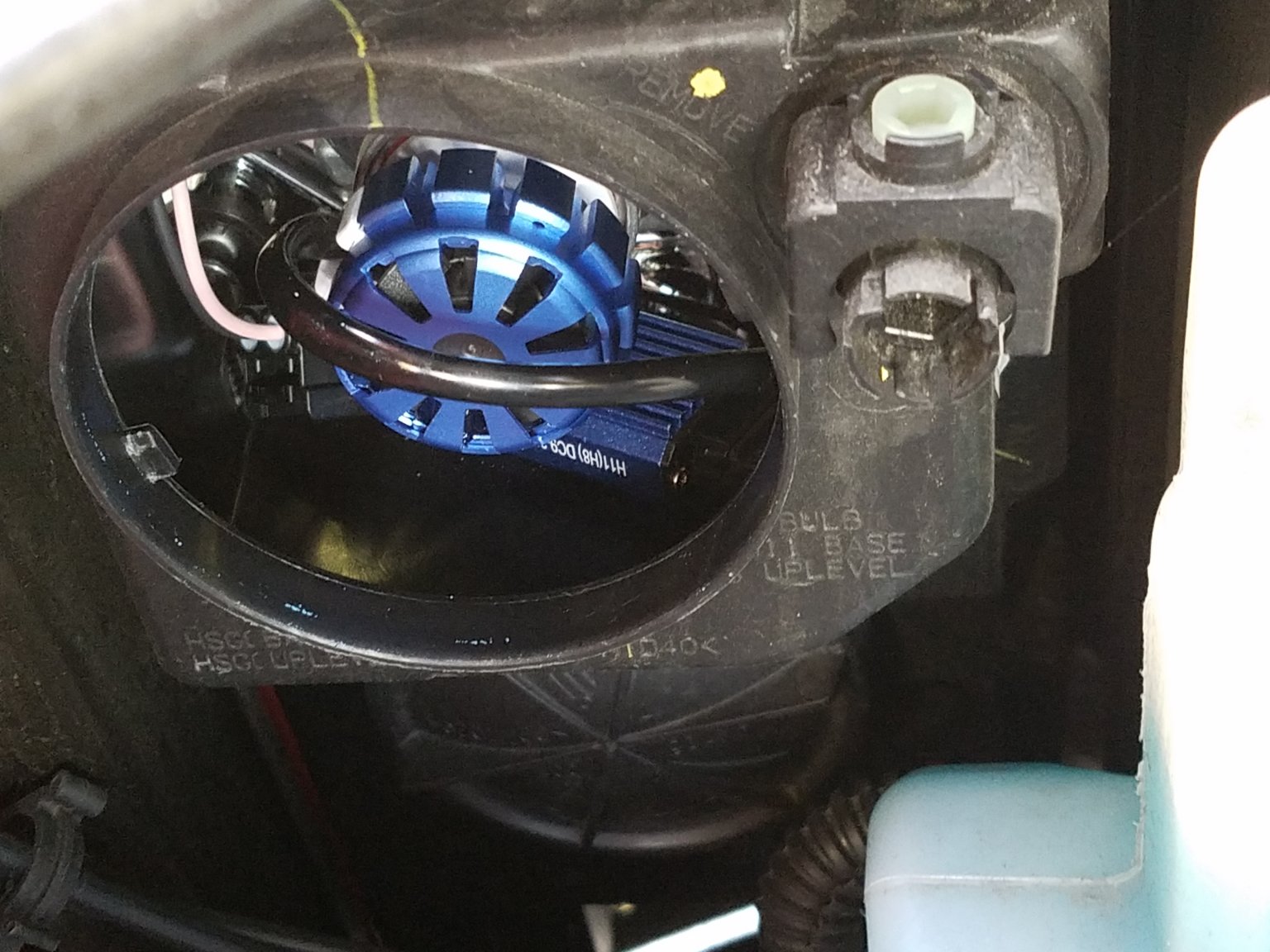

I swapped out my H11 bulbs for H9 bulbs. Extremely happy with them. You have to trim off a tab inside the connector on the bulb. Easily done with a razor. Or hot knife. Bulbs are brighter, whiter, patterns well with a wider beam. H9bulb: 1700-2200lm; H11: 1100-1400lm
Cmicasa the Great XvX
Oct 7, 2014
131
35
the hotter bulbs could damage the projectors. Even more if they also work as Drl on base model Tahoe and suburban. Watch out for this.
I have been running them for almost a year.. no issues and no heat problems.. they also have and actual fan in the unit. On the Yukon the DRLs are separate
20161025_152222-jpg.68505
The comment was specifically about the Tahoe with Drl on low beam projector.
It would be great if you could give us a shot and do a comparison. You would be very impressed with our lights. I highly suggest you to move away from led bulbs on projector headlights.
