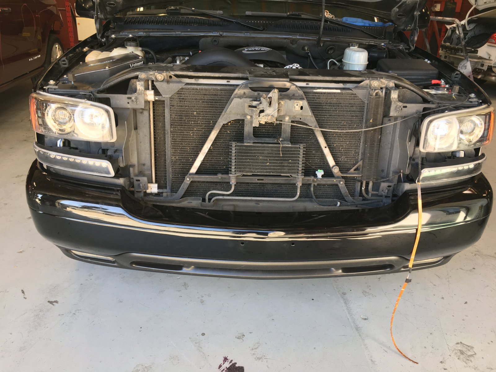

As you can see I installed aftermarket grille from eBay and painted the chrome grille surround black as well.
