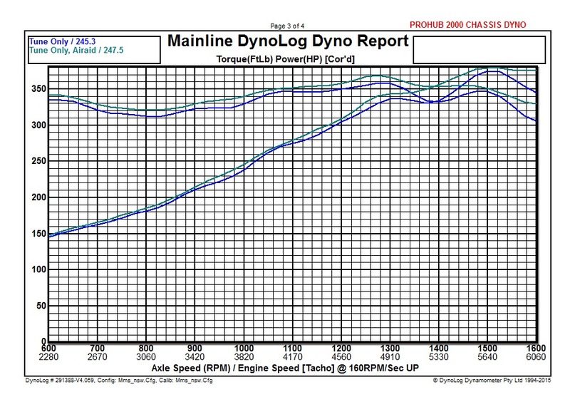

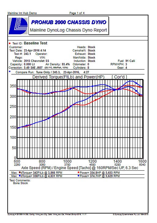

Do you have a stock run without the intake?
Here are the two sheets I have access to ATM.
Stock vs tuned (2015 Chevy SS):
Tune only vs tune with AirAid (2015 Chevy SS):
All of our dyno pulls and tuning were completed with intake and coolant temps at comparable levels to ensure no temperature bias. Temperature changes will wildly impact the actual power results (not to mention even just strapping down a vehicle slightly different between runs).
