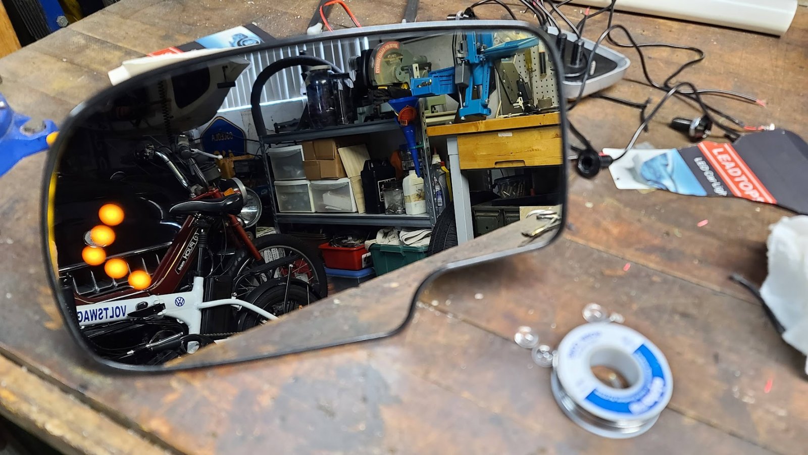

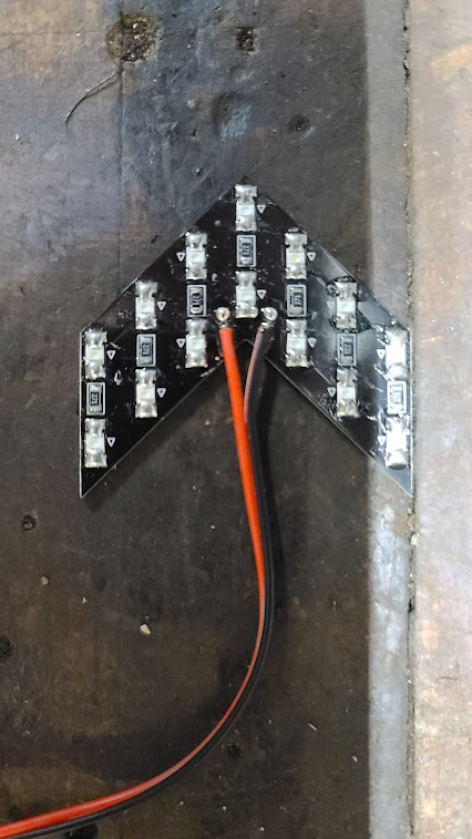

I didn't like the turn signal arrows I got. Not very bright, couldn't see them in daylight.

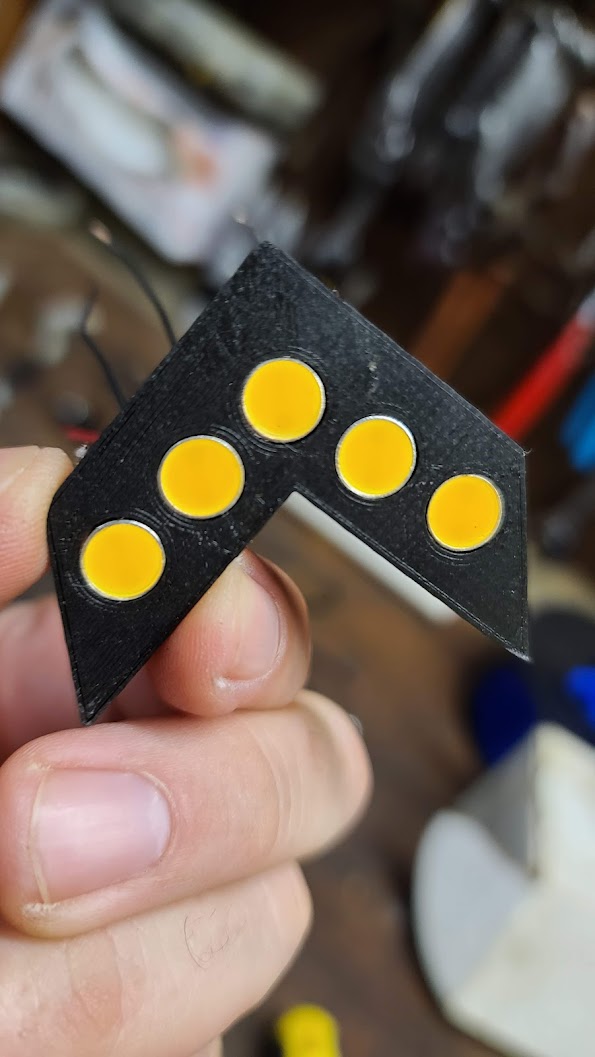

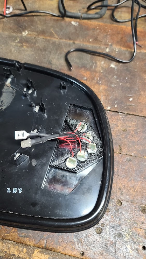

I decided to make my own using LEDs, from another project, that I know to be bright. I had been using white, but for the mirror turn signals I decided on amber. Using the arrow that I didn't like I 3d printed one with five holes for the LEDs I plan to use.
I'm happy with how it came out.
