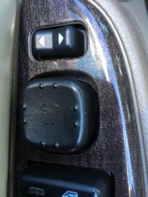

Could it be possible that the mirrors were changed? I tried that and the mirror glass itself moves, they don’t fold in or out

If your mirror glass is moving than the selector arrow is not in the middle. It’s pushed to the left or to the right which will move one side mirror or the other.

Double checked it’s in center, that’s the only time when that part of the switch lights up. Unless my window switch needs replacing?

I just double checked my switch, which I know is fully functioning. The square directional adjust button has orange back lighting when the side arrow is in the center position. It does NOT illuminate when I switch it to left or right side for adjusting each side. So it would seem your switch is functioning the same as mine. But it shouldn’t be moving the mirrors when in the Center. With the arrows in the Center position, and illuminated, when you move the left and right side of the adjusting square switch, which mirror glass moves?!

Both driver and passenger sides move

Yeah that isn’t supposed to happen. Lol. It could be that the side selector arrow part of the switch has gone bad. I would pull the switch off the door panel when you get a chance and inspect the wires going into both pigtails for side mirror adjustments first. There could be a bad wire going into the switch causing the issue. If the wires check out then I would try a new switch. But I’ve never had this issue before so I’m taking shots in the dark. Lol

Sure thing. Quick question. What does your mirror adjust switch look like? This I presume:
Or does your square button have a different symbol on it?
