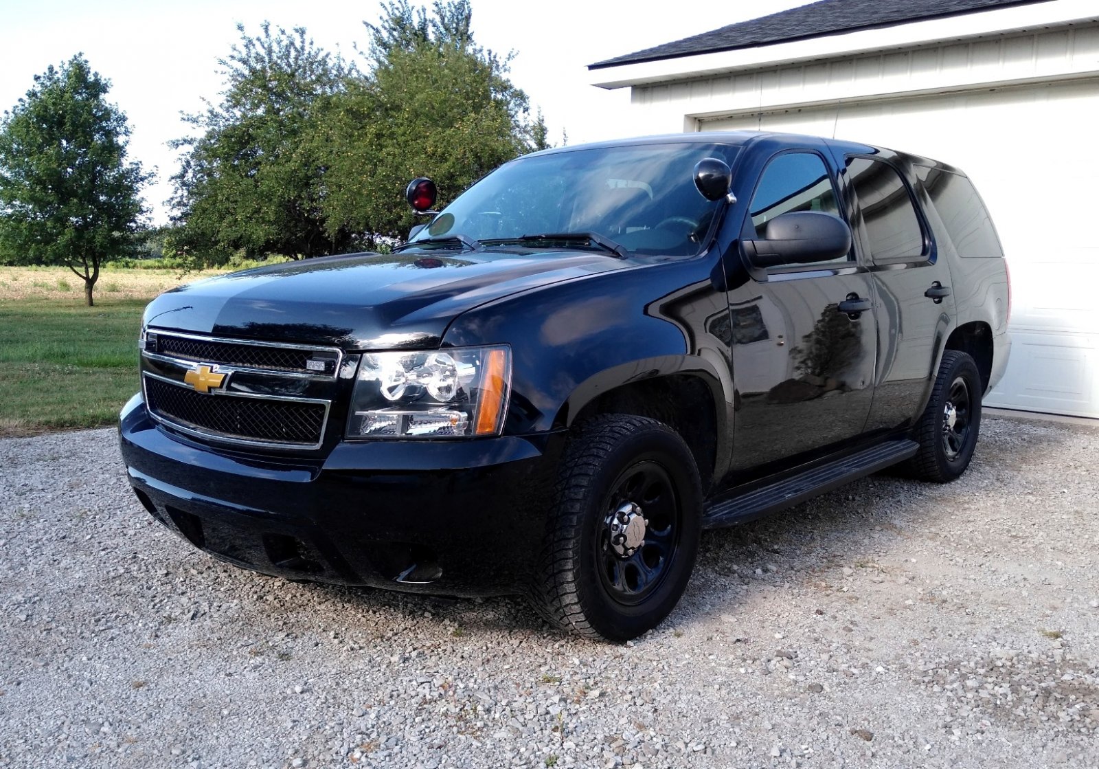

Well this kinda blows my mind. I have owned several of these SUV's,
both PPV and SSP and have always been told these are not "plug &
play" with the tow haul mode.
But you guys have convinced me to buy the tow haul mode shifter
arm 25807851 and try it on my 2013.
I asked about this PPV Tahoe tow haul mode question on another
car club website and was referred over here.
Thanks guys!

well i finally got around to installing my steering wheel with the audio controls and the shift lever with tow-haul today.
both were a success. Push the button on the shifter and now I get the little trailer icon on my dash.
