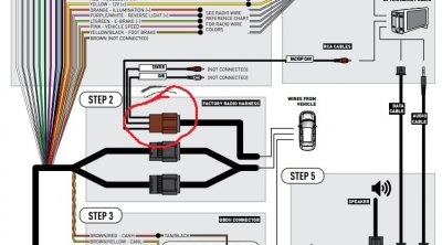

I have 2014 Tahoe, I am installing a Pioneer AVIX 5201 NEX, I have the idatalink Maestro and the harnesses. I have an adapter to plug into the harness and RCA to plug into the head. I can not find the vehicle harness for the camera (currently displayed on the rear view) or for the rear audio center. any idea where I can find these? I have search this thread and only saw where you need to splice in on a 2009. Thanks

I have been to there site and have all the guides. This is the vehicle connector I can not locate

Which harness did you end up with? It should have been the hrn-rr-gm2

I have the hrn-rr-gm5+ ( no nav) I also have the hrn-av-gm5

I should have a gm5 at work let me look at it when I get there.

Thanks, Appreciate it. So I am not confusing you I have attached a pic of what I have. The 2 black connectors are going to the factory harness that were plugged into the original radio. there is the gray connector that has 1 black wire going to the Pioneer and 6 RCA plugs (labeled from rear AV input, the other says to overhead screen) there is also a brown connector
with 3 RCA's (Center out, Sub out and Backup camera in) I am assuming I only need the gray or brown. I cannot locate a factory harness for these to plug into.
I assume the iDatalink will control everything except Video feed.

I figured out the AVG5 is just for rear video (which I do not have, just rear audio) now I just have to find where to tap the video feed to put the video for the camera to the Pioneer. it says pin 6&7 blue and white, I do not see those coming down the drivers A pillar.
