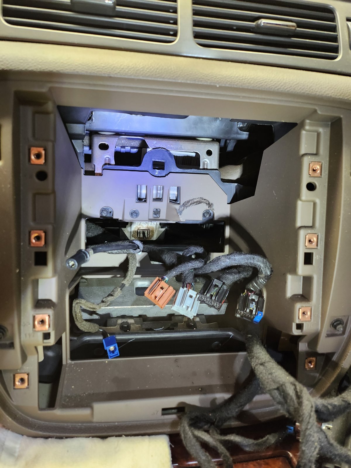

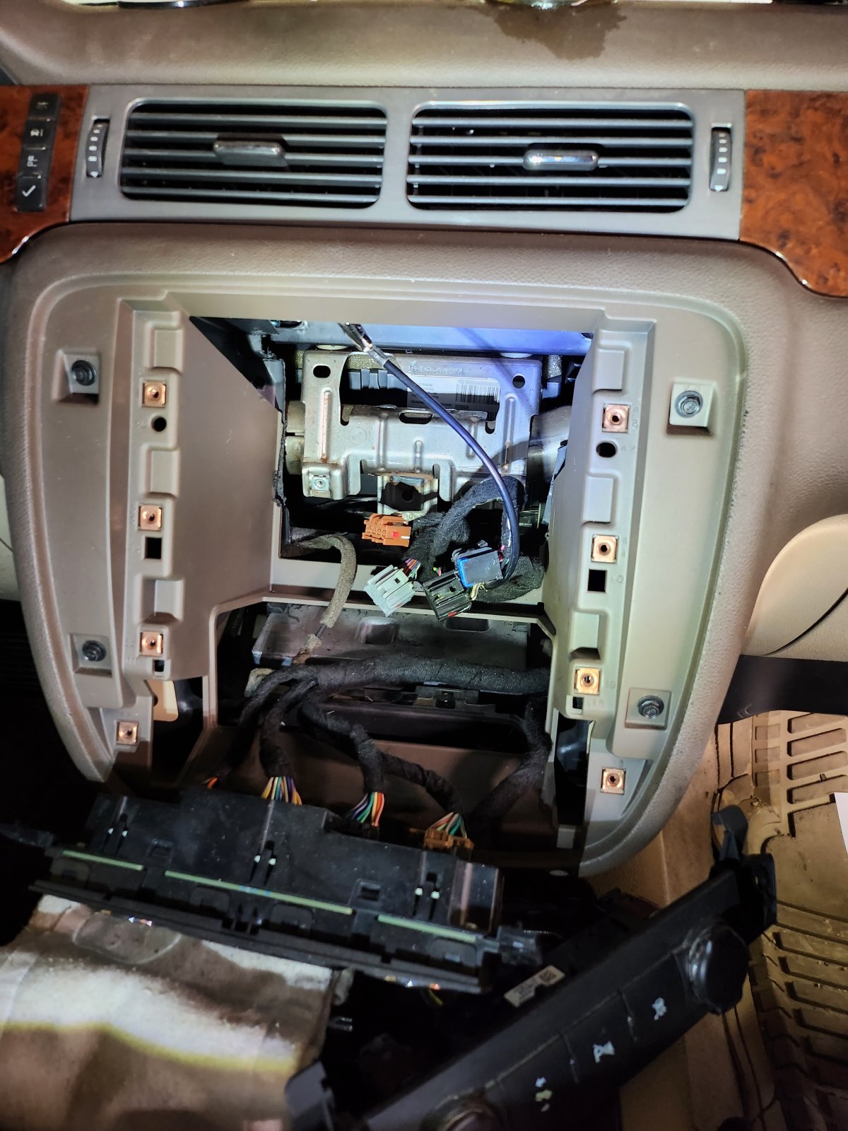

Before:
After

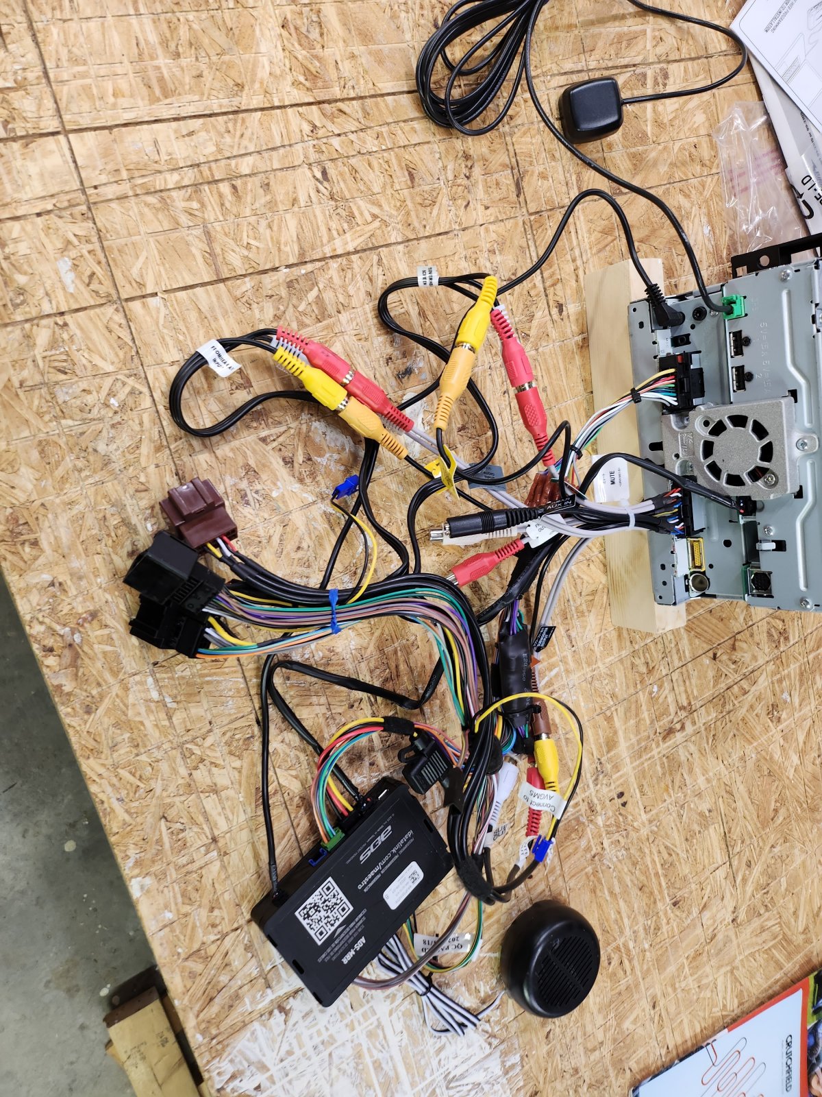

And the readywire harness from Crutchfield.

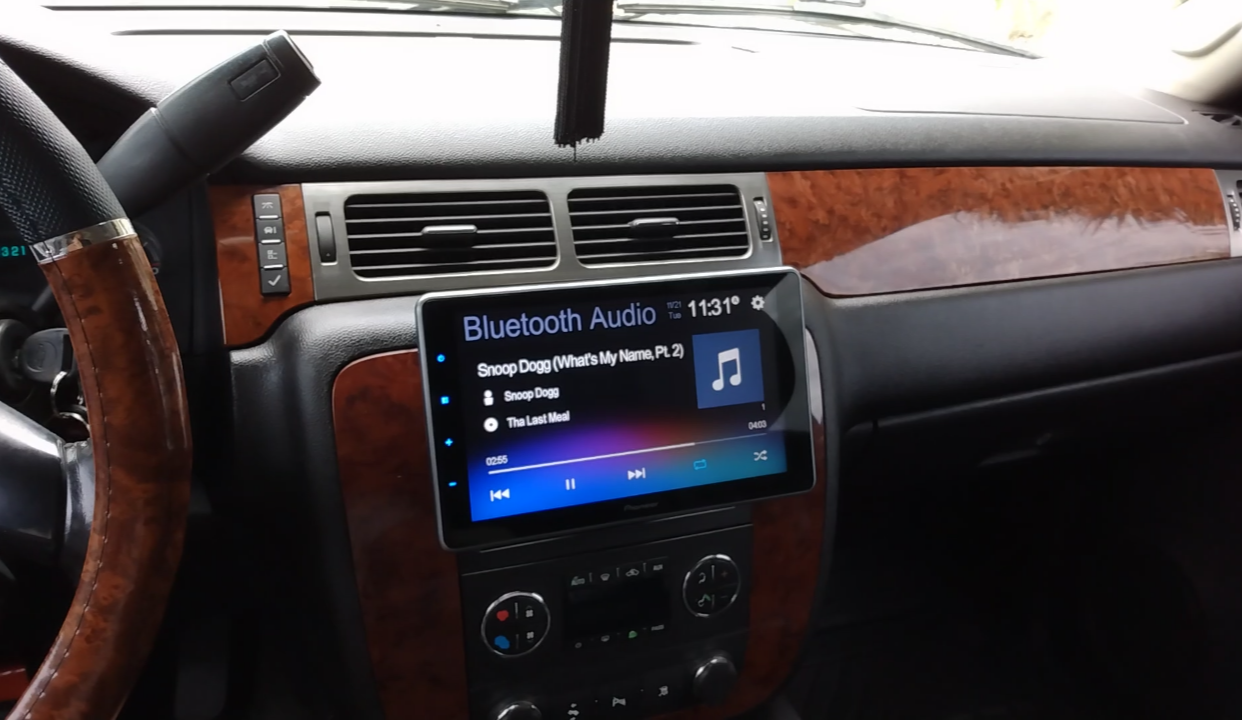

Thanks! I've wanted one ever since I first saw them. My only gripe is missing actual volume buttons or a knob and having to look to adjust. it's amazing other than that (especially the larger back up cam view) and gives the dash a sleek and modern look.

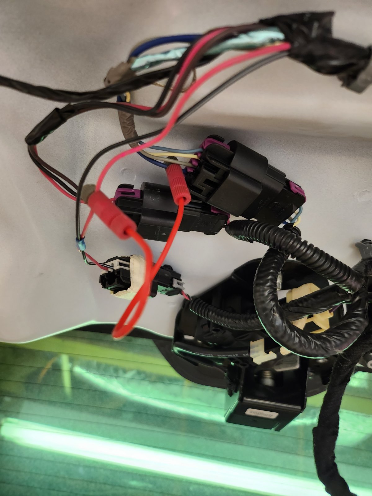

I was just looking back through this thread and didn't see the picture of the jumped wires. The wires are in the tailgate at the rear wiper.
The red wire is my jumper.

Awesome, thanks! Ill give a try tomorrow am and let you know how I make out. - Dan
Dngrmse
Jul 18, 2016
24
I jumped the cables as pictured, but still had no video. Taking a closer look at the adapter provided, I saw that it had the 2 pins opposit of where they should have been. I backed out the pins and put them in the right place, and that worked, so now the camera is working. Thanks again for the help!
