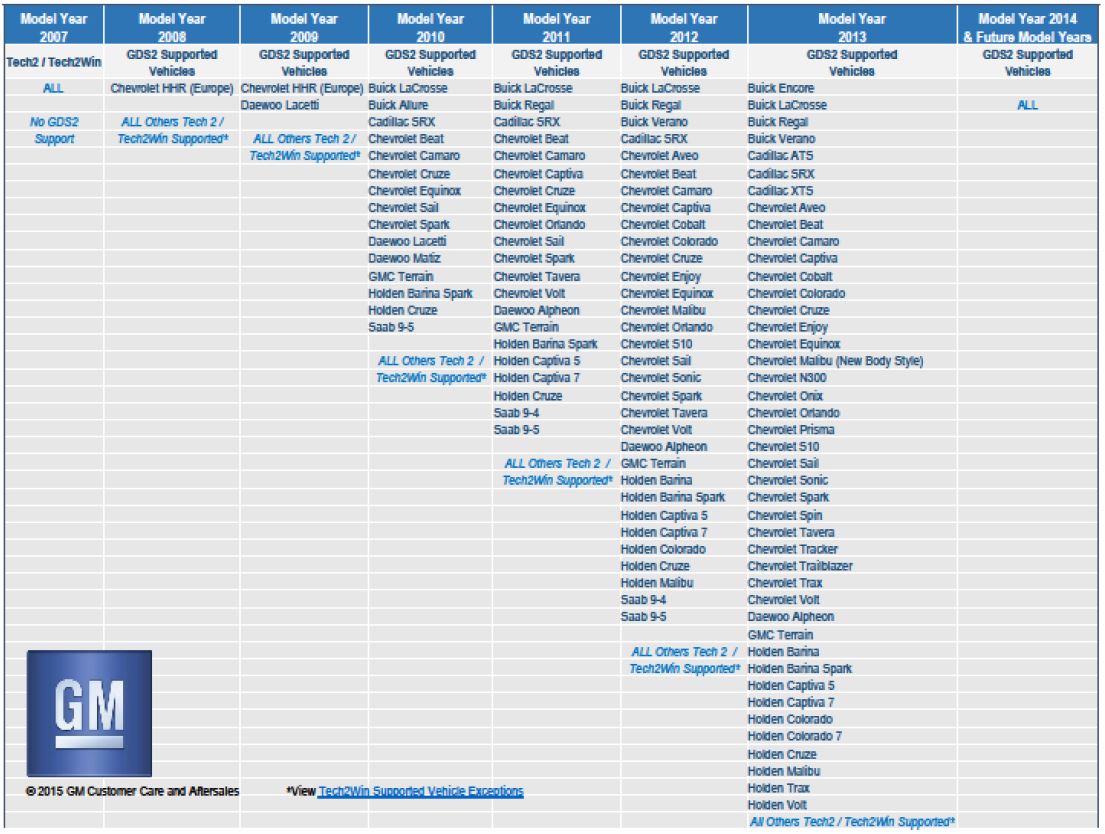

When working with GM Tech 2 is the best you can get. No other scan tool is going to give you the level of integration with your vehicle and its one of the only scan tools that will give you bi control of pre 96 obd I vehicles. Most scan tools even the high end ones will only allow you to get live data and read and clear codes.
Since Tech 2 is only good up to 2013 models and only a few of them as GM started making the change to the Global platform in 2009 it may be wiser to obtain the VCX Nano on Amazon for GDS2. This will allow the Tech2 back to 92 and up to previous said 13. It uses a emulator called Tech2Win which is used on your laptop and connected to the OBD1 or 2 by the connector then to a laptop. The true bonus is that you will also have the GDS2 system up thru 2018 model year. This will allow you to also with a 3 day subscription download updates to your modules on the vehicles when and if you get a more data crazy vehicle.
The cost of this wonder is about 100 dollars and I know it works.

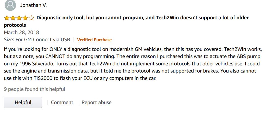

Sounded great to me, until I saw this review :(

No, it actually ‘simulates’ all the tech2 functions on a laptop, from what i read it works well but you need a laptop in the vehicle whereas the trch 2 is a semi handheld unit. I started looking about a month ago and came across it but stopped reading because.........’oh look squirrel ‘.....
