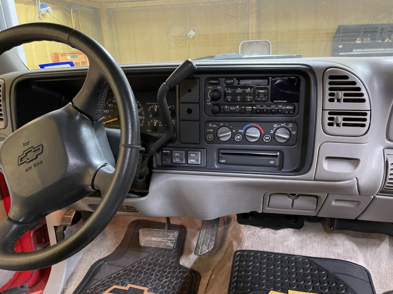

AC vent removal? Can these AC vents be removed without taking the dash apart?

The ones on the right by the glovebox just pop out. The ones in the bezel have tabs on the inside (usually covered with tape) and can be removed once the bezel is off.

Yeah guy sorry, I'm still try'n to figure how to use this forum. Never been on one before. I was gonna add all my info but after I inserted the
pic of my dash it wouldn't let me comment for some reason? So I had to post my ? in the Title..
I thought I was in the "How To" section? As in "how do I do this?".
I didn't want to break my vents if they needed to come out from the back side.
I have a '99 2 dr 4x4 Tahoe LT. Thanks for responding,,, I'll get better at this
Thanks man, that's what I needed to know. I just didn't want to break 'em by pull'n them out from the front.

Good deal. Try to re-tape the center ones if you can, they don’t stay in very good without it.
