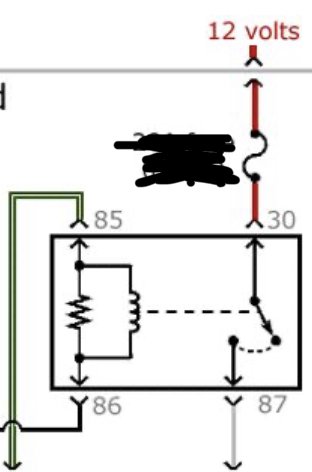

If the clutch isn’t even cycling you either have a failed clutch, locked up clutch/compressor, fault in the wiring or relay check all hvac fuses and the ac relay (swap with a known working relay) a broken pressure switch would keep cycling when there’s enough freon in the system to run like normal if you want to test your clutch I believe you can feed it 9v and it’ll fire however if it’s functioning as it should but low on Freon/ no pressure it won’t cycle even you can jumper the relay temporarily to see if the clutch engages and if it does you either have a locked up compressor or pressure switch issues like low freon

A easier way to force a clutch engage is with a jumper wire on the relay it also determines if there’s a issue between the relay and the clutch sometimes the clutch wires get chewed especially if it’s lowered

if you complete these 2 connections the clutch comes on cross the 2 shortest distance across legs side to side and it’ll force the clutch on a 10$ flip switch on and off GM 4 leg relay test tool does the same thing and if op takes it to a shop that doesn’t just open the parts cannon it’s the first test if this makes the ac function exactly how it’s supposed to it’s just a bad ac relay
